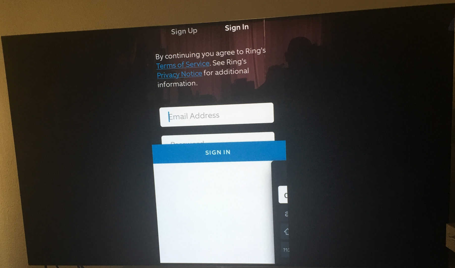

Anyone here have the Ring - Always Home by Ring.com app working on their Android DISH Device such as the Hopper Plus. On the Hopper Plus, it's not in Google Play Store so I had to sideload the Ring - Always Home 3.73.1 by Ring.com apk from apkmirror.com using the nodpi version.
With DISH Hopper 3 on software H376 and the Hopper Plus on P19202, this is what happens when trying to sign in except the keyboard is not showing up correctly on the screen and only a small portion of the left side is showing up:

I may try that sometime with my Ring cameras setup.
