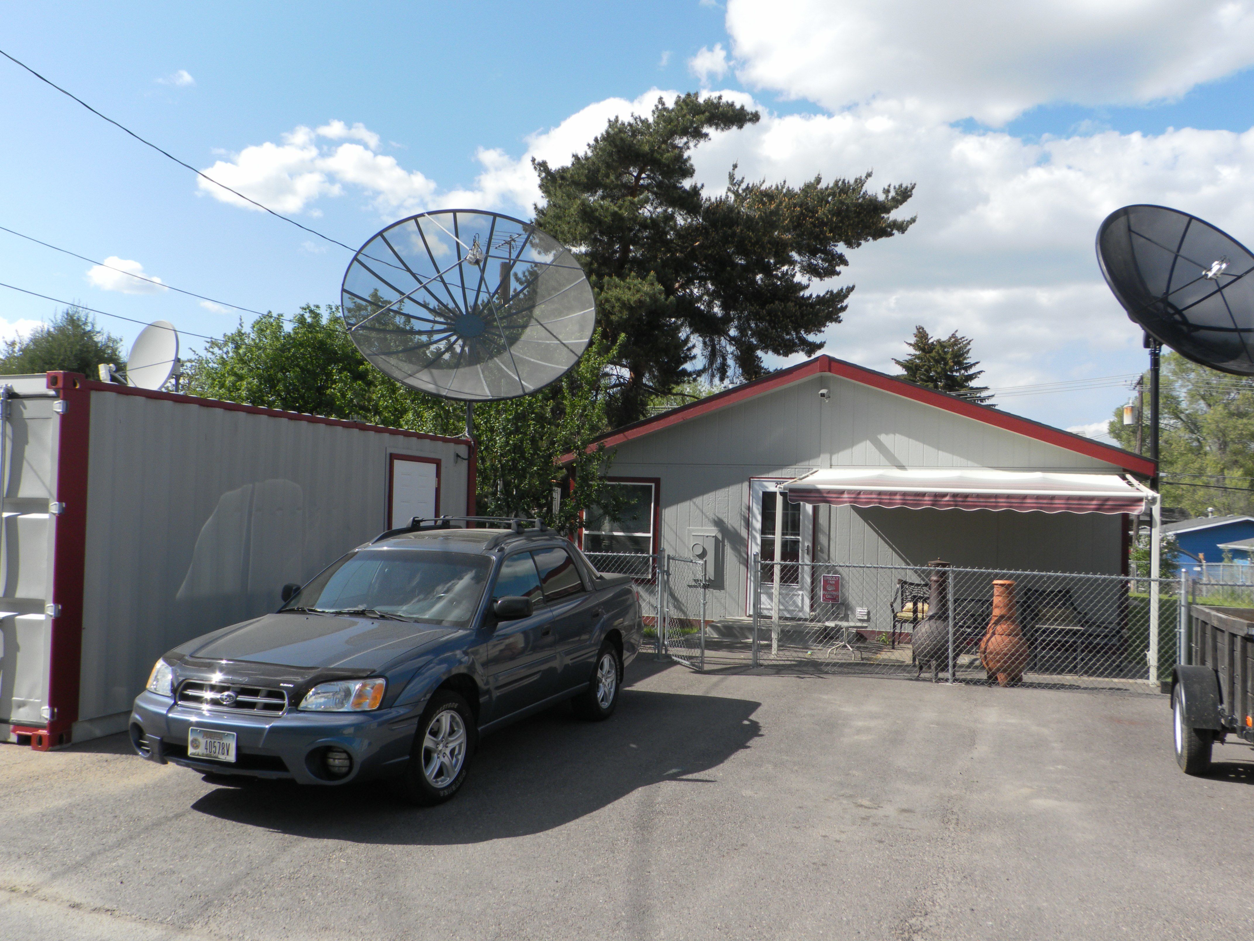

I agree also. I much prefer to have the dish near the ground. But sometimes we don't get what we want.
