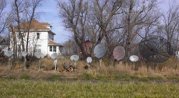

Someone said I am starting a "dish farm". I presume that to imply a lot of satellite dishes installed. Oh no.. No no no no...... Do. Not. Want.
I still insist on having only one that moves around. I can paint it to look like a big sunflower. :)
But a bunch of them? No thank you. That's what I want to get away from.

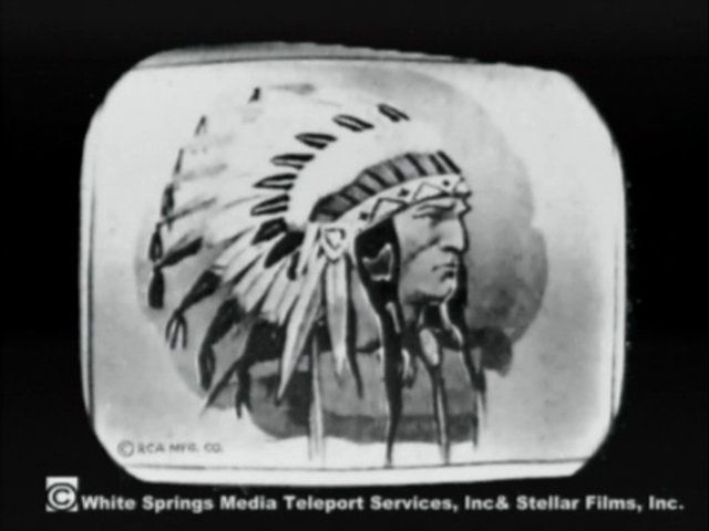

I am watching White Springs TV right now! @party:clap@party
The bird dog would not see the 129 satellite at all so I changed out the lnb for a different one then used the birdog to find and fine tune BR Dishnet 129. The meter showed a 100% signal and 98% quality so I bolted everything down tight and changed the lnb back to the original one.
I went inside and Ta-da! There it is. In all it's terrible glory, WSTV!

Can you say DIIISSHHH FAAAAARMMMM.......lol
