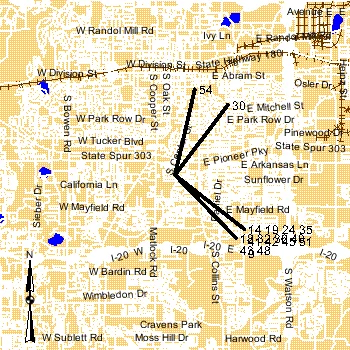

I have stealth and it works great... It's even mounted bellow the highest pitch on my roof.
But I'm pretty close to the transmission towers about 12mi. and all the important stations are located in the same place :)
Make sure you check antennaweb.org to make sure you have it pointed correctly.
