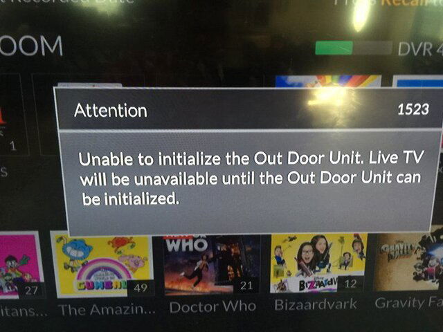

all4jo SatelliteGuys Pro Original poster Oct 5, 2004 394 9 Haiti and lexington ky Apr 4, 2018 #1 Has anyone gotten this error? unable to initialize the out door unit .live tc will be unavailable until the unit can be initialized. Attachments B3CB9280-E9BA-402E-AE14-96039DE521D5.jpeg 67.6 KB · Views: 743

Jim5506 SatelliteGuys Master Pub Member / Supporter Lifetime Supporter Oct 19, 2004 8,259 3,756 Slaton, Texas Apr 4, 2018 #2 What kind of "outdoor" unit do you have? Is this an RV install? Reactions: bspei
HipKat SatelliteGuys Master Pub Member / Supporter Aug 25, 2017 18,900 37,052 Pekin, IL Apr 4, 2018 #3 Your cable needs to be connected to port 1 on the LNBF. This error means it's connected to port 2
all4jo SatelliteGuys Pro Original poster Oct 5, 2004 394 9 Haiti and lexington ky Apr 5, 2018 #4 Well I’m using 3 antennas. Connected to dhp42-then 2 hybrid nodes to 2 hopper 3 and 2 joeys
HipKat SatelliteGuys Master Pub Member / Supporter Aug 25, 2017 18,900 37,052 Pekin, IL Apr 5, 2018 #5 all4jo said: Well I’m using 3 antennas. Connected to dhp42-then 2 hybrid nodes to 2 hopper 3 and 2 joeys Click to expand... Which order are they connected to the switch. Should be 119 to input 1, 110 to input 2, 129 to input 3. Your power inserter is cabled correctly?
