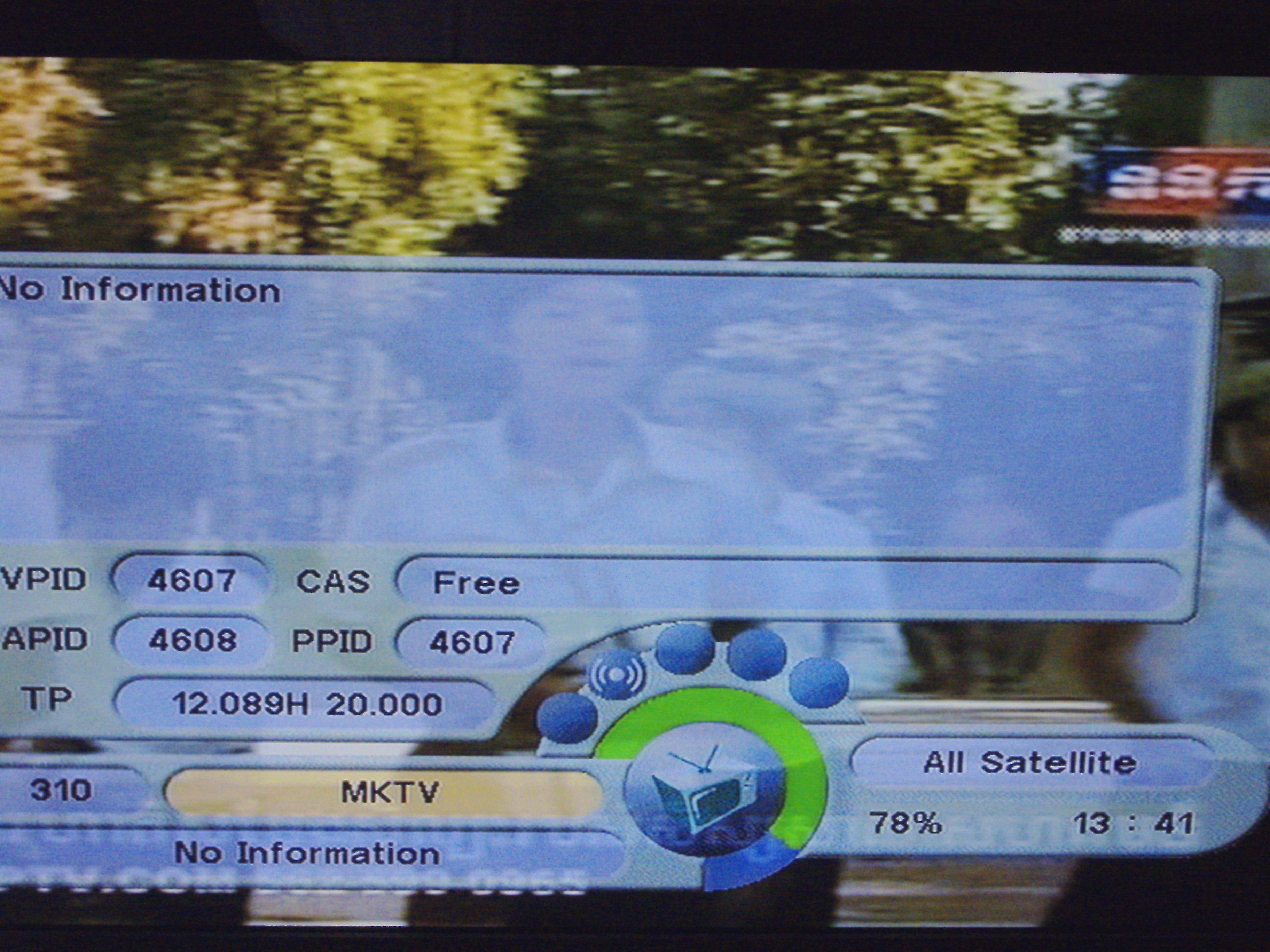

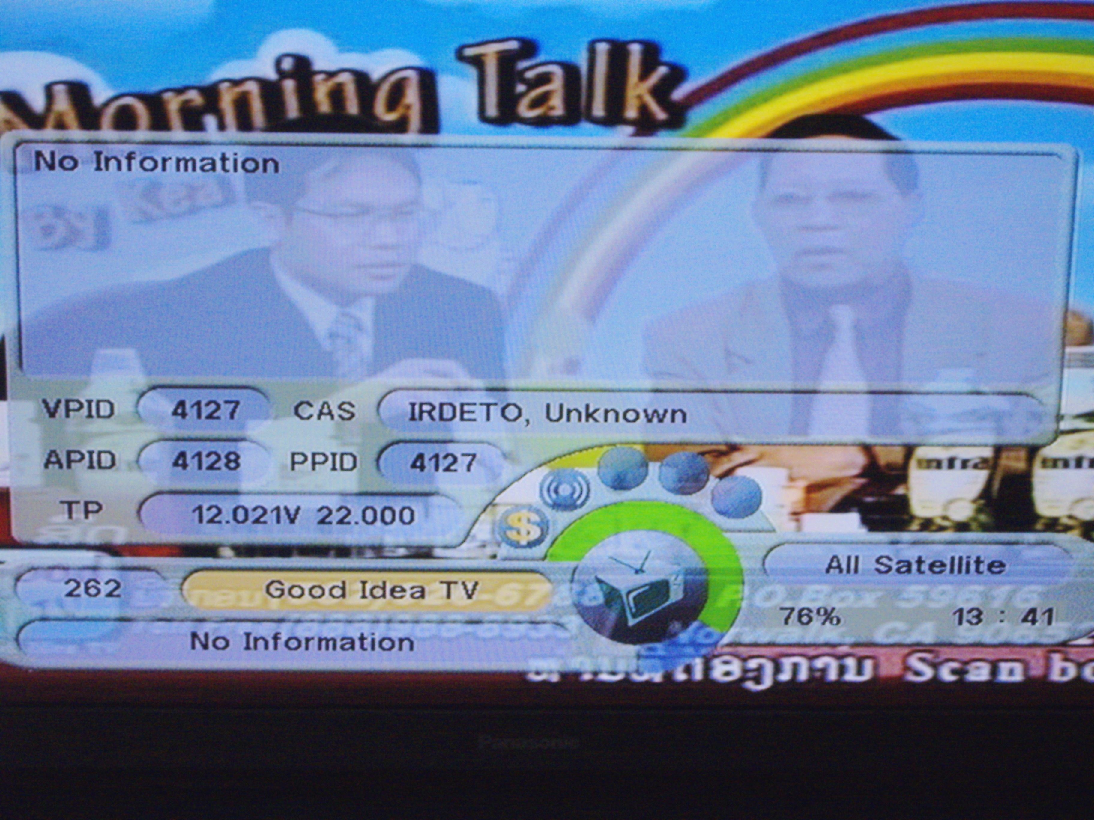

by the way I just checked and both are up and working. Goodidea claims its scrambled but its not

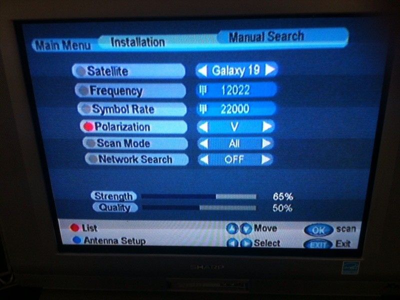

this is the screen im getting when input the transponder, freq, pol.
that looks right. So when you scan it shows the channel scanning in but it doesnt show after you back out?
nope. also notice the signal isnt green. is it suppose to be like that?
