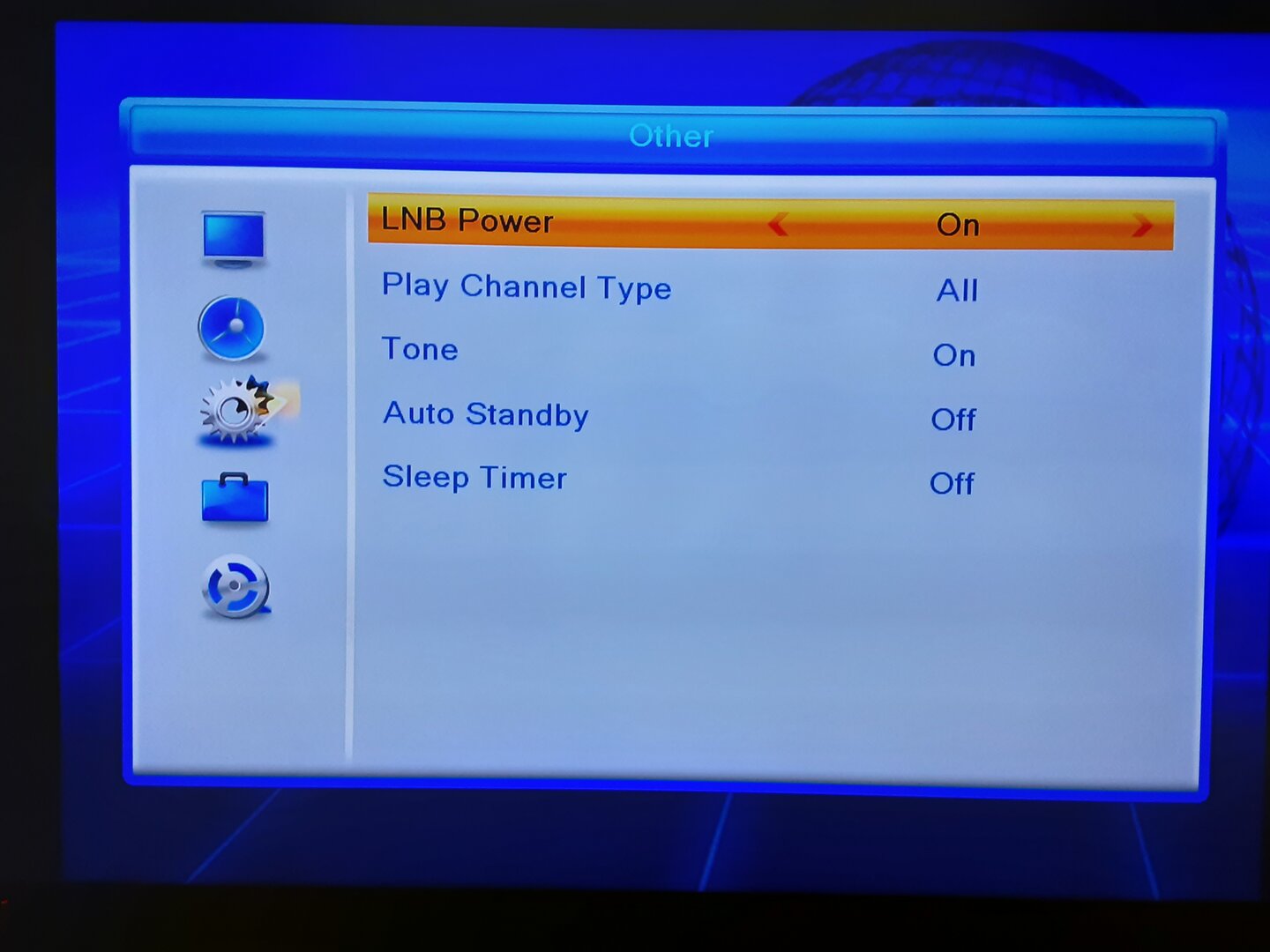

I just powered mine on for the first time in years. I don't see an 20220825_203930.jpg LNBF power setting.
