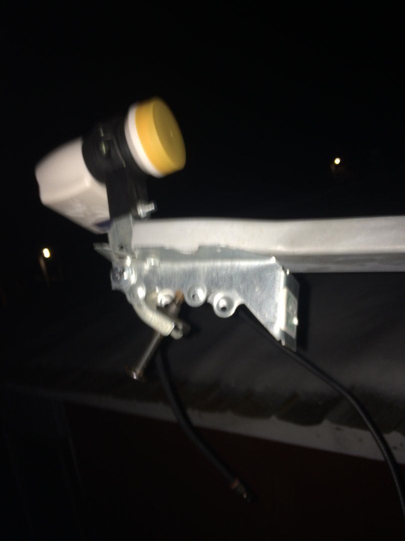

As for the lnb bracket ill have to get a pic but for now ill describe: I bought a bracket from amazon, put a u bracket under the dishes org arm, connected the two(using the old lnb to try to mount new in same manner) with a bolt thru the two with a sleeve in the center for locking down purpose, then put a u clip over a hole in the bought brack with a bolt so i can fine tune the up and down angles then lock it down. I actually works well, ill have to take some pics to gave you a better idea of what im saying, lol. There should be a pic now

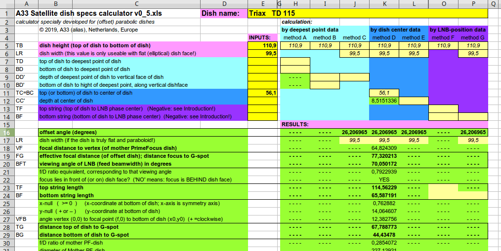

Or even better: I would check and calculate the focal point, if it is a flat face paraboloid dish. "Original" LNB positions are not always right.
For that: mark top and bottom, left and right side of the working area of the dish, and the center point of the dish.
Then measure hight and width of the dish, and distance from top to middle of the dish (which should be equal to bottom to middle); as accurately as possible.
From these data the exact focal point can be calculated. (I could put the data in my calculator, and give you the results.)

very interesting, i'll have to take a closer look at those methods. By "to or bottom" to "Center of dish", am I understanding correctly that you mean the distance in straight line from the top to the point that is equidistant to top/bottom edges and equidistant to left/right edges but also right on the surface of the dish (hence the slightly higher value than half the top-to-bottom value)? If that is correct, isn't that more sensitive to slight measurement errors than measuring the depth against a straight edge going across the dish? (I have not done the math, just wondering though)Alas, satsig is not accurate; I tested that.
Also Parabola Calculator 2.0 for offset dishes (using Paul Wade's method) is not accurate, as it pre-assumes bottom at vertex. A slight difference there causes abberations for the focal point. (For PF dishes I believe this calculator is OK, though!)
Parabola6 is highly accurate for focal point calculations of paraboloid dishes, though. And gives a nice drawing of the results.
However I find the depth measurement of that calculator rather difficult; I find the measuring procedure that I wrote above simpler, and by using the top/bottom spots again I think you get more accuracy in the input measures.
So I made a calculator that can use three different types of input values:
- center point input values, such as mine and Parabola6's;
- deepest point input values, such as Parabola Calculator 2.0 (but without the incorrectness of the unnecessary preassumption of bottom at vertex). I have noticed it is very hard to find the exact deepest point, though;
- LNBfeedhorn point input values, when you know the feedhorn position is accurate (simple method, to find the effective focal distance of offset dishes, for e.g. multifeedcalculations).
If a dish is wider than high, but it is still paraboloid in form (to reduce impact from neighbouring satellites), with the water method you can still find the "effective width", and do the calculations.
If a dish is wider than high, and it is a multifeed dish, it is usually parabolic in the vertical sense, and circular in the horizontal sense. That is also the case with toroidal dishes.
I have a calculation method for those dishes in my mind, needing also the water method. And it would not be a proper 'calculation', but a step by step algoritm (by repeated steps, algoritm in the original sense, I believe?), to come very very near the true value.
But that calculation is still on my 'to do' list, for somewhere in the future, and the method is still untested...

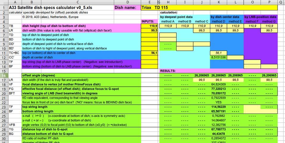

Example of calculation of my triax-115 with the 'dish-center' method is added.
Also the other calculation methods, and needed inputs, are shown.
