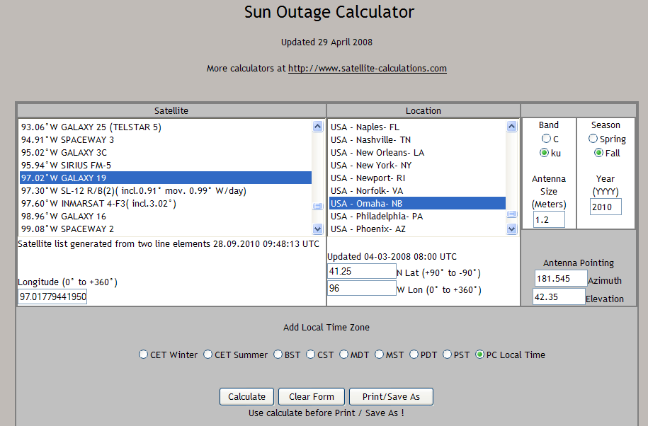

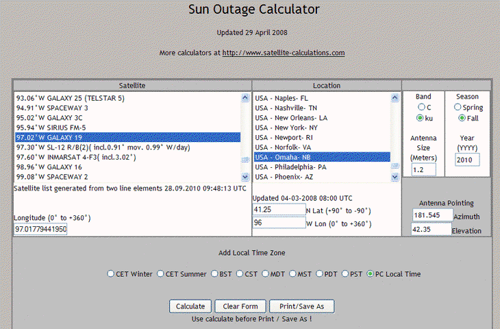

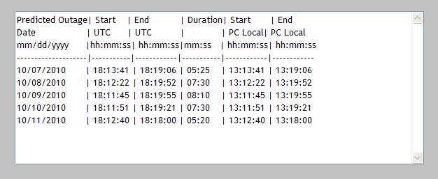

I use the same calculator that FaT Air does:
Sun Outage Calculator
I have attached some screen hunter images of the calculator.
You can select the satellite you wish to check and the city nearest you from the lists which are part of the calculator or you can simply type in the satellite's orbital position and your site's coordinates.
Then, select your band type (C or Ku) and your dish size (not sure how critical that entry is) and then the season you are going to check (fall or spring) and the year. Then, select the time "zone". It is best to select PC local time as then the calculator will use the time that is on your computer so you don't have to worry about any conversions.
Then just click CALCULATE and the results will be present below.
On the left, it will show the dates to look and on the far right, it will show the time relevant to your local PC time from start to finish.
