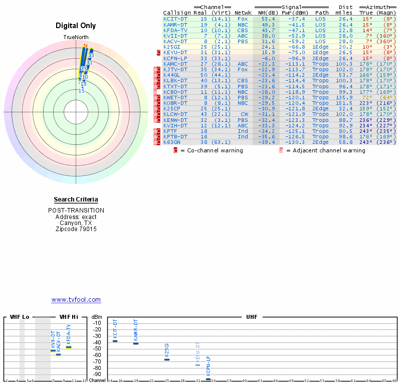

Hey guys,
I am looking for some help on choosing an antenna for my local digitals. I don't know much about antennas at all honestly. I know I have one VHF (7) and the rest are UHF. I would prefer to keep the antenna small if on the roof or maybe even stash it in the attic. Thanks in advance.
Here is a link to my TV Fool
TV Fool

you have 2 stations on VHF....PBS is on 8 (remaps to 2)

Those channels listed as "Green" (the major networks to your North at 7 and 15 degrees) should be easy to receive. If you have a rabbit ear antenna of any sort I would give it a try inside first. I'm talking about one of those expandable retractable antennas ( looks like a V) that used to come with portable analog TVs.
If that doesn't work well I would then try the same simple antenna outside a window close by.

Those VHF signals are just strong enough that it should be worth trying the HBU33 in the attic by itself with no amp at first. Another worthy performer is Winegard's HD-7694, which is at the same price point. Either one should provide enough gain to get those three VHF stations through a plywood-and-shingles roof. (All bets are off, though, if the antenna must be aimed through a gable end finished in brick, stucco, aluminum siding, etc. Ditto a radiant barrier on the underside of the roof deck. Then you'll need to go above the roof.) Install the antenna and run a cable to a single TV first to verify reception reliability. If your reception gets sketchy after adding more sets, you can always add a low-gain pre-amplifier (Winegard HDP-269) or distribution amplifier (Channel Master CM3412, Winegard HDA-100) near the antenna to overcome signal loss through the splitters/wire runs.

I ran a TVFool report on their old house on Mesa Drive and it came up very similar to yours - so if you go with an attic mount bump the antenna up one size, maybe a Winegard 7695.
