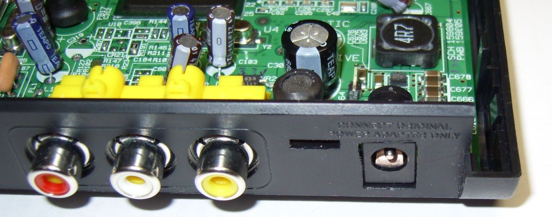

Looks like my only complaint would be the power plug.
I wanted to use a cigarette power adapter and it looks proprietary.
I also didn't want to use a power inverter as that uses more energy and drains the trailers battery faster.
Do you know of there will be a adapter being sold by Dish or 3rd party so this would become portable and great for a emergency.
OK, there is simple mod by your wish: desolder old proprietary connector and install regular one after triming a window for it on back side.

or buy a couple of male female plugs and attach inline. then all you have to do is unplug the ac adapter and plug in the car one. if you're interested i can try to post a drawing
