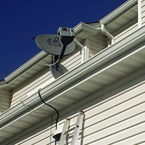

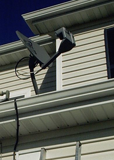

Maybe. Certainly is the first one in my area.
I just installed it today - for SpringsGuy. :D

NO NO guys that 2nd dish you see behind mine in the picture is my neighbors crappy lil direct TV dish LOL... I only have 1 dish, the Dish1000 and its working just fine i am going to post a thread about the install to tell more...
Yeah looks like a mini super dish possibly but its a 1000, and looks killer compared to my other neighbors crappy Single Lnb Direct Tv Dish, and my other neighbors dish500..
That isn't a bad looking dish. I never went to the Superdish because it was so large and ugly. But I could see swapping out my D500/D300 combo for a D1000. Although I'll admit I might get cheap and just repoint my D300 from 61.5 to 129.
The Dish1000 is going to be a peice of cake to install compared to the SuperDish, much smaller, much cheaper in price, and better signal quality, along with better looking. The only bad thing about it is that it will only output to two receivers without an expensive DPP-44 switch as the SuperDish had the DP-34 switch included.
