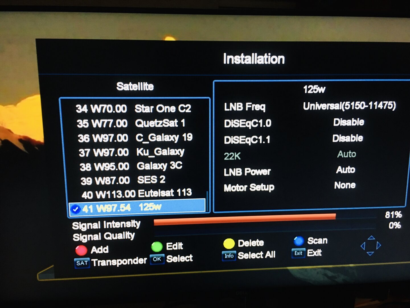

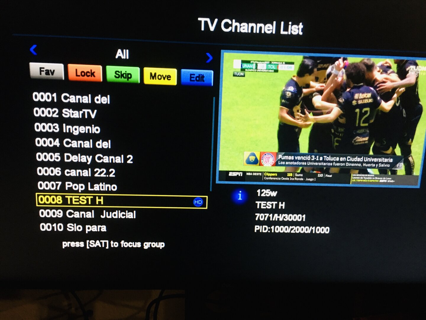

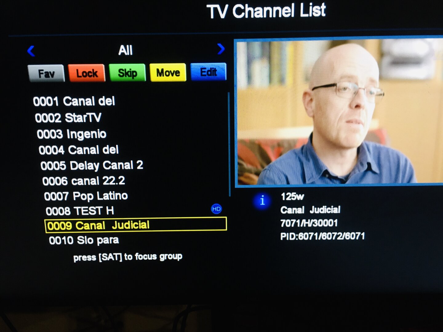

11780 H 30000, you don't list any signal strength, are you getting it as well, or is it leftover from a previous scan?
Thanks Keith. I moved and also got a new receiver GTMedua SS7. A little bitty thing about 7"x3"x1.5 and now I get several unscrambled channels in addition to the scrambled ones. These are:
1–>15 as per the following pictures.

You are on 116.8W, but your transponder numbers are weird, shouldn't be 4 digits, and the one that is 5 digits (13000) is off as well. What is the LO setting in the receiver?
You are right, I forgot that I changed the LNB to universal 5150-11475 and forgot about it after a few scans and other unrelated tasks. Old age…LOL.

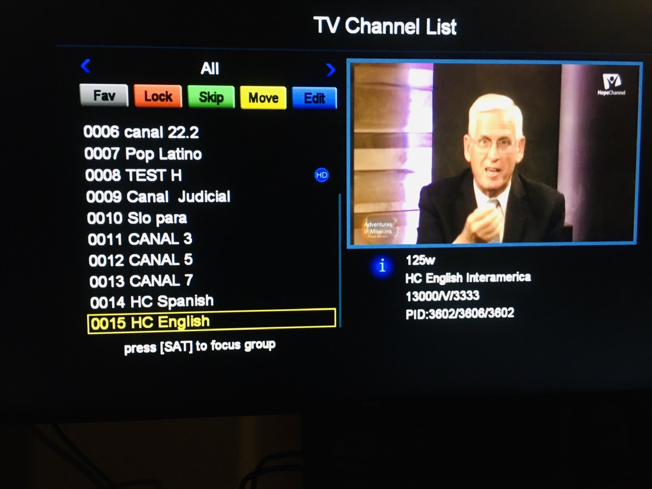

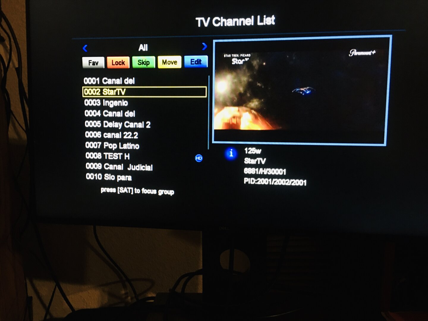

Thanks a bunch finally conquered the monster an after two moves I when they to 125W AMC21.
I get close to 90% Sig. Strength and 72 Signal Quality, so I am in business with PBS on satellite. I was much more difficult to find the signal than when I got at North Ontario-Canada.
Thanks Keith and all other that gave their time an experience to get this old foggy back to Satellite.
