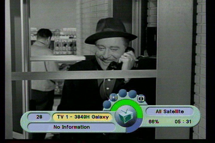

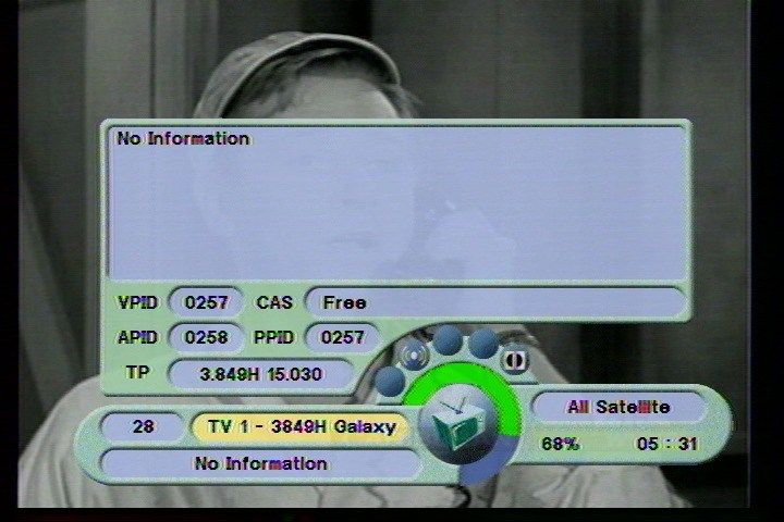

A couple pages back you showed a screenshot of NASA and it showed 66% quality on the Coolsat. Note that 63/64 is the minimum threshold so you're barely above that on a good signal. On my Coolsat 5000 (same receiver pretty much) NASA shows 73/74% with the 6 footer. So you're very close but just require some tweaking. Try and twisting the LNB a little bit. Push it in towards the dish to optimize signal and minimize interference.

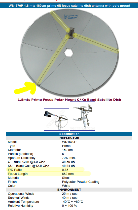

The photo on the WS website shows this dish with the lnb arms attached to the outer most edge of the dish.
First off, when I was putting it together, I found no holes on the edge.
Also, the tabs on the ends of the arms where not bent in a way to facilitate that sort of assembly.
I tried it though and even if you were to attach the arms in the way shown in this photo, the lnb would be like less than ONE FOOT from the face of the dish. There is no way possible that is correct.
Obviously they are showing a photo of a different but similar model of dish.
There are slots on the sides of the panels that DO facilitate mounting the arms in the manner that I did, as you can see in my photo of my dish. It also holds the lnb out away from the dish at a distance that LOOKS like it would be proper.
That said, they list some focal point stuff for the dish. I ~ASSUME~ it is the information for the dish they are displaying in their photo. That dish is not the same as the dish I have.
DUH......
It says the focal thing is .38 OK, fine.. So I put the lnb mark to "38". Right??
BUT, being that my dish is DIFFERENT than the dish they display on their website, I ~ASSUME~ the focal stuff is different too.
But, what to set it to? I saw some very complicated math BS where you have to measure all sorts of things and then do some long, drawn out, complicated math to get the setting. I can't do that.
Does anyone know what I should set the lnb marks too for MY dish?

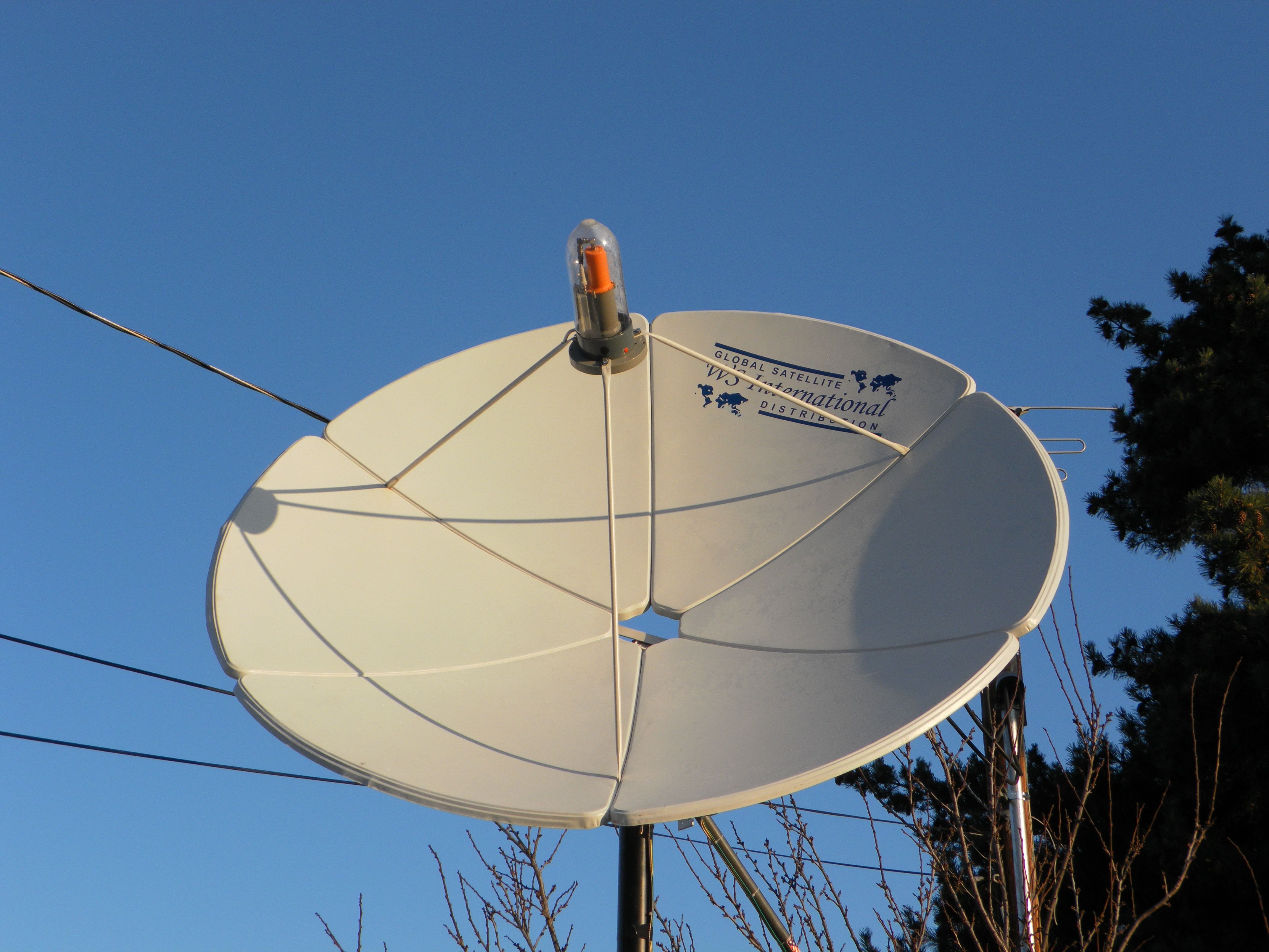

Hi Dee_Ann. Glad to see you got your system working :) I think you're onto something with the arms not being in the right spot. The correct focal distance is important for proper operation. In your last post the pic for the dish specs said the focus length for that dish should be 682mm which is about 26.8 inches. If you measure from the center of the dish to the feedhorn is it 26.8 inches? If it isn't then probably the arms are in the wrong spot or they aren't bent properly. I seem to recall a while back ( a year maybe ??) someone on this forum had problems with the arms on their dish. I think it was that the wrong length arms were shipped but I'm not 100% sure. I'll try and find the thread. here's one for the larger size dish and he had problems with the arms. see the product weaknesses section where it mentions the arms and look at pic jul_21. http://www.satelliteguys.us/fta-mpe...iew-ws-international-ws24095-240cm-prime.html my bad wrong size dish. it looks like your arms are where they should be. here's another thread for the 1.8m dish http://www.satelliteguys.us/228237-6-foot-dish-install-9.html
refresher course
This thread is mandatory reading for anyone assembling that dish:
http://www.satelliteguys.us/free-air-fta-discussion/228237-6-foot-dish-install.html
In post 31, mr3p describes focal length, and LNB arm location
At post 43, Corrado covers a clever way to pre-align the scalar/LNBF to the center of the dish with some 2½ inch PVC.
There are lots more discussions and tons of pictures on page 6 & 7, concerning how to align the motor to push the dish reliably.
There is no question on the LNB support arms. If they were not in the right place you would get nothing. This dish does work.

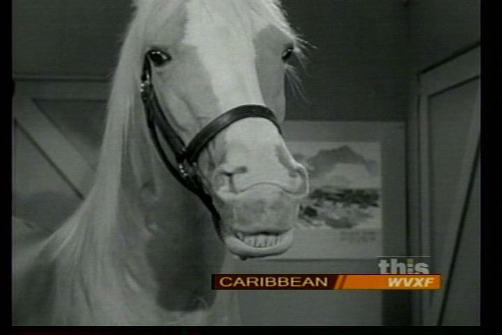

Like right now, I found Galaxy 16 @ 99. I'm watching WVXF right now. thisTV is playing Mr. Ed and the banner says "Caribbean WVXF"
The picture is clear and sharp and no gleep glop glitches or blocks. It just works.

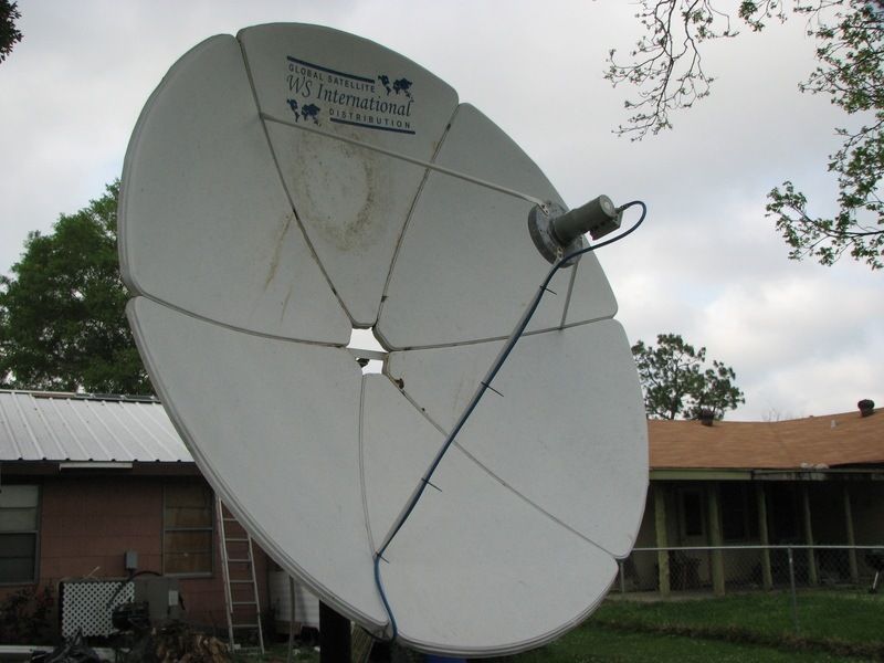

Dee...............I have that same Bargain Dish, I didn't bother using the number scale on the LNB at all. Through trial and error I set it.
From the back side of the Dish, run a Tape Measure thru the center hole up to the face of the LNB. It should be about 28 1/2 " ( from the crossbar behind the dish to LNB face)
And the Support arms are in the correct location for THIS Dish.

Photto
DUH......
trial and error. No number is universal. Its all trial and error to obtain the best signal
Oh, and the coolsat? The stupid meter on it goes away if you move the dish so then you have to press the remote buttons over and over. It won't keep the meter displayed. VERY annoying.
go to antenna setup, then manual scan. Once you get a signal locked you can go into manual scan and the meter stays up until you turn the machine off or back out of the menus
