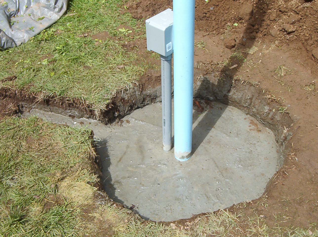

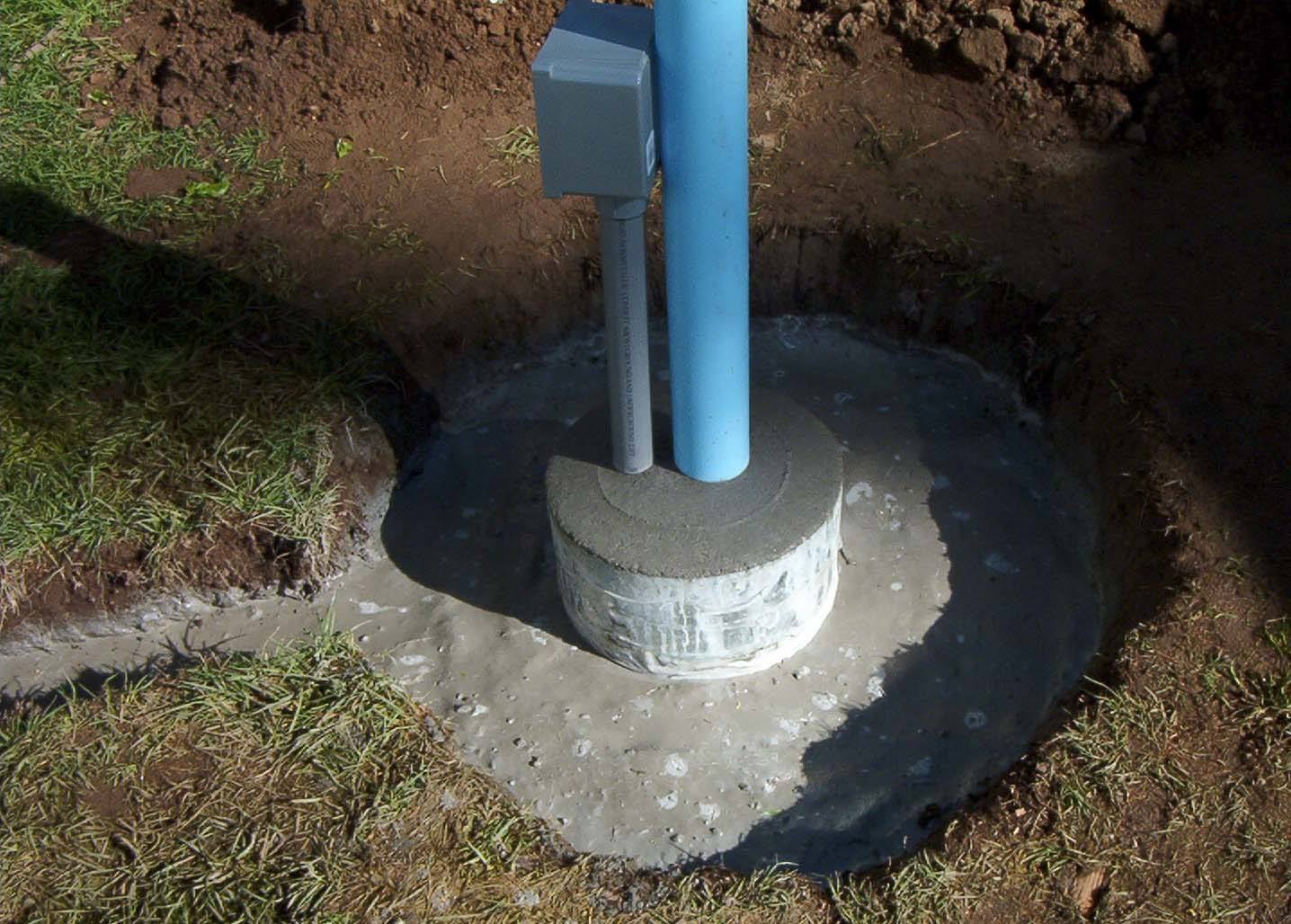

The pipe is 10 ft. above ground.
The hole is 3 ft. deep and 3 ft. wide and it is more wide at the bottom of the hole than at the top. Also there are 3 "spurs" dug out about 6 inches around the bottom and 3 more at bottom sides.

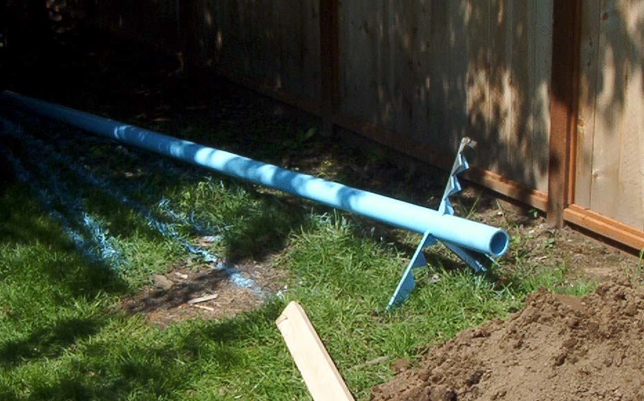

The pipe has three 1 ft. pieces of angle iron welded one ft. up going out at an angle to keep the pipe from twisting.
The hole is filled with 35 bags of concrete and that is 2,800 lbs. holding that pole down.
So bring on the wind! (And I pitty the poor person who tries to dig this pole out someday after I am long gone!)
Here are some pictures if I can do this right...

BTW... The jagged edges on the pieces of metal welded to the pipe are there because I told the welder he could use scrap metal. And these were pieces of scrap metal he had laying around.
And I painted the pipe blue so that my dish install might fly better with my "female" neighbor (her favorite color is blue)...
