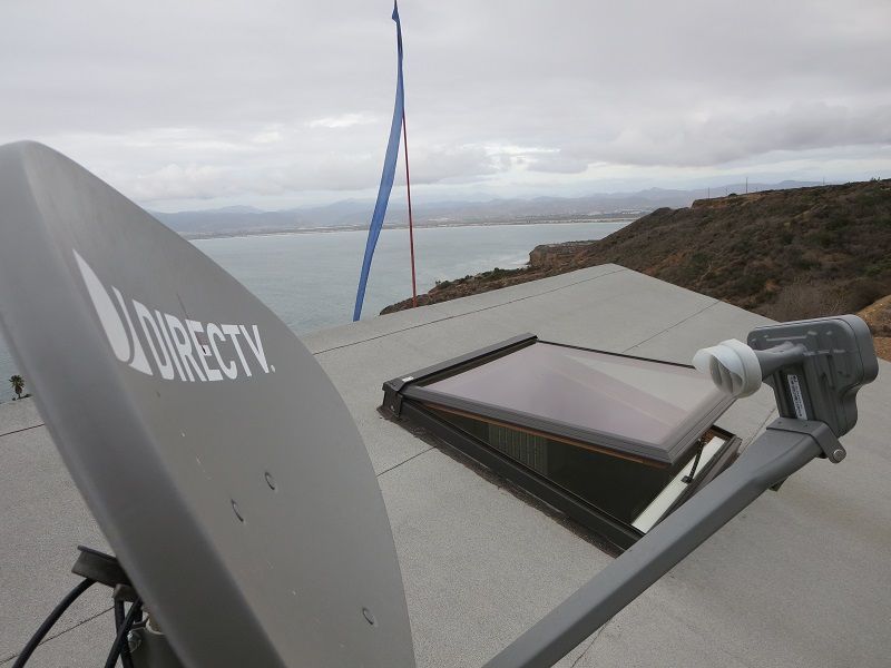

Supplier insisted no B Band converters needed on my HR24-100 receiver.

this non swm lnb with HR24-100 receiver. Will add BBCs to 2 cables tomorrrow for dish point. Then will switch setup(physical+menu) to swm.
