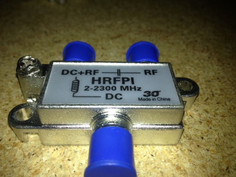

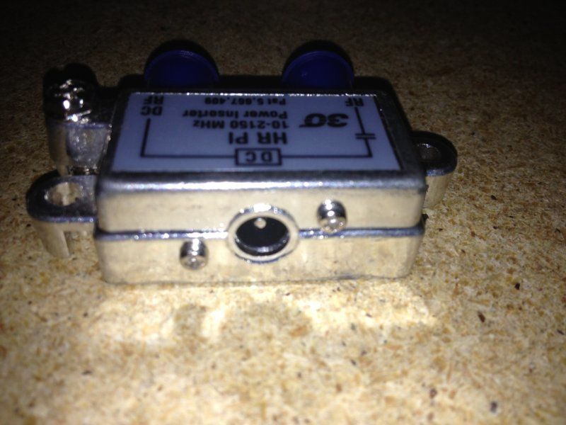

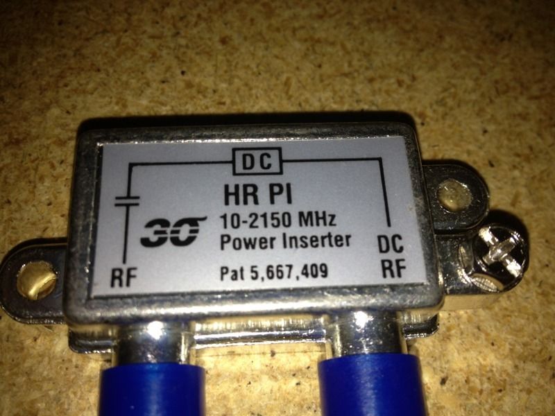

Is there a simple way to power up a HH motor(preferably using a coax cable) so all I need to do on the main cable is send USUALS commands and power the LNBF? I need to use a 4-port diseqc switch before the motor. Thanks.
Could use these to.

Good Question! I will need to research and test to verify. I typically don't use voltage blocking splitters.
In this case it shouldn't be necessary to block the voltage before inserting the fixed 18Vdc.

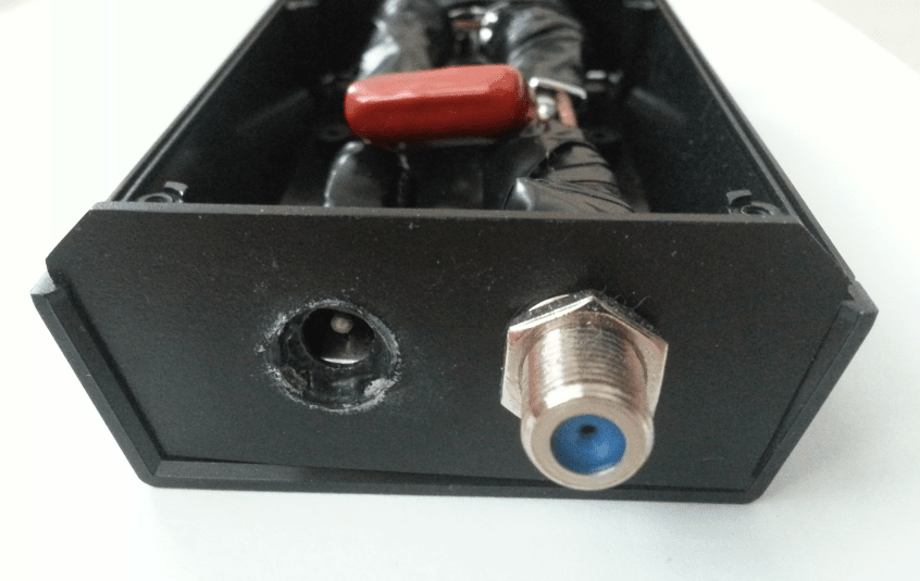

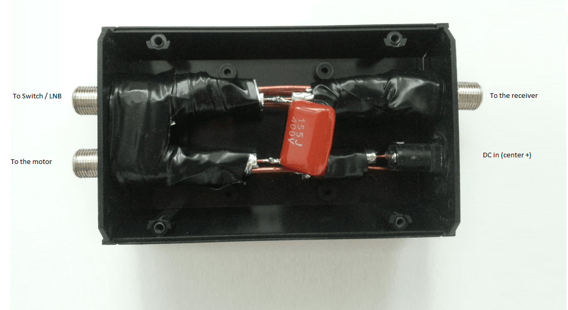

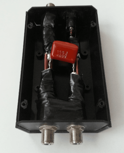

I put together my own splitter with a capacitor to pass the 22 KHz DiSEqC commands about a year ago and used it successful until about three weeks ago when I put together a Raspberry Pi / Arduino DiSEqC controller which I am now using and testing.
