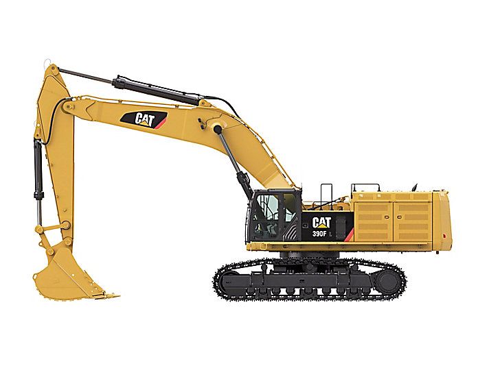

C10059380.jpg :biggrin

I was not talking about a ditch witch, that is a machine. I was talking about a tool that done it. I seen the Primestar installer use it 20 years ago but have not seen anybody use one since. He just pushed it along the ground and put the coax into the slit that it made. I heard someone else mention this tool recently as well.
