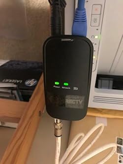

What about putting the Genie-2 (HS17) and seven DECAs in the communications closet. My understanding is the DECAs convert from coax to ethernet. So all the coax needs are satisfied in the closet. Then I take the ethernet/CAT6 output from each DECA and run it out of the closet to the Geminis that are located at each TV. The remote and Gemini are near each other, so they will communicate.
Any concerns with this config?
If that would work, then how would each Gemini also be able to get Internet, for Netflix / Hulu / Max?
Are the coax side of the DECAs plugged into a SWM?
And the HS17, which is plugged into my LAN for an Internet connection, is also plugged into the SWM?
So, the Internet passes through the HS17 to the SWM to all the DECAs to the Geminis?

you shouldn't need the DECAs because the HS17 takes the ethernet signal and passes it over coax for all the downstream devices. all you need to do is make sure all your receivers are genie mini/gemini wired on coax. no DECAs needed because those boxes can work with the HS17

The deca adapter will also need power from a micro usb cable from the back of the Gemini to the deca adapter.
You can use anything sort of USB power supply for it, it doesn't have to be powered by Directv equipment.
Though as stated, you don't need a DECA at all. The only reason you would use DECAs is being under the umbrella of Directv's "official" support.
