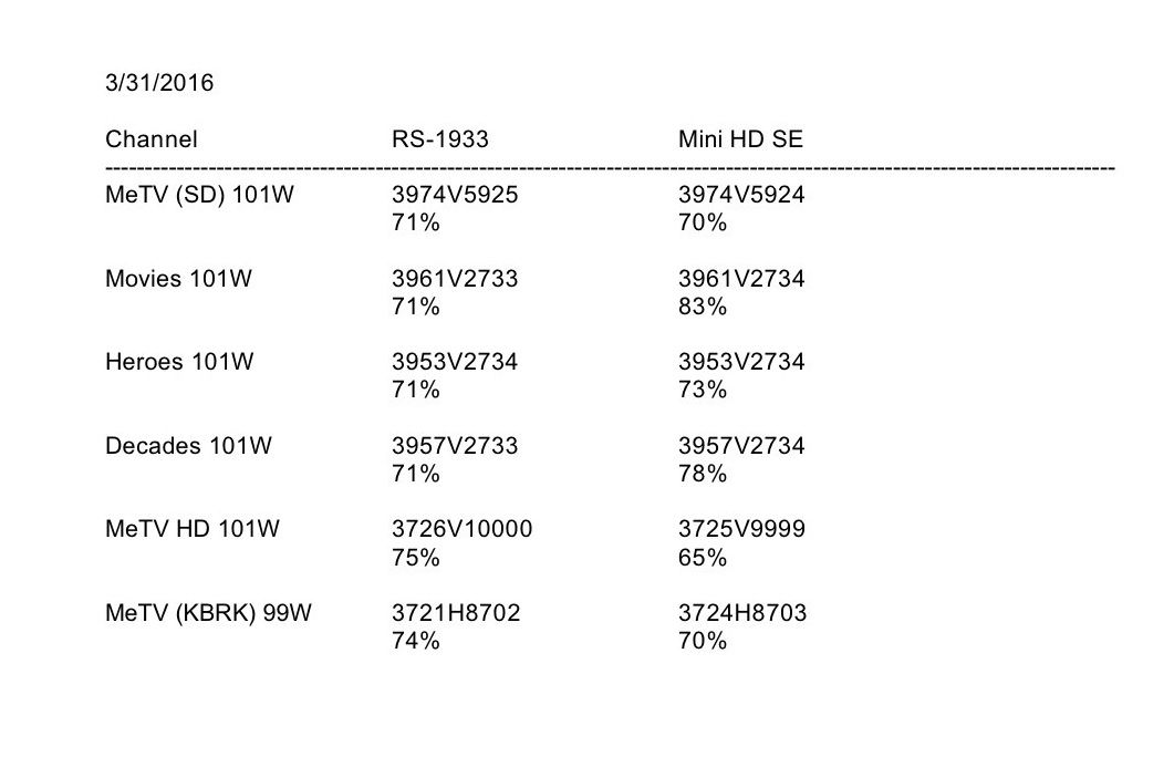

The other night, after reading this thread, I ran some tests out of curiosity. It was nothing more than to compare Q readings and TP info between my two main receivers (see attached file).
A 10' dish with a Titanium C1-PLL used. Dish moved to satellite, actuator controller tweaked E-W to verify on target and Q read from TP info screen on first receiver. First receiver shut down and then receivers were swapped, second receiver powered up and testing resumed
For this test, the transponders on the 1933 were older scans that were working fine. The transponders on the Mini were scanned that evening.
