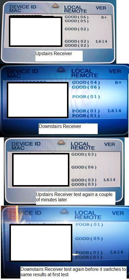

Yes I have done the test from both receivers. Before I hooked up the homeplug ethernet adaptor, the tests would show only the receiver that I was running the test from. After the adaptor was hooked up, it shows both receivers and the homeplug. But the remote receiver still shows up only as offline.

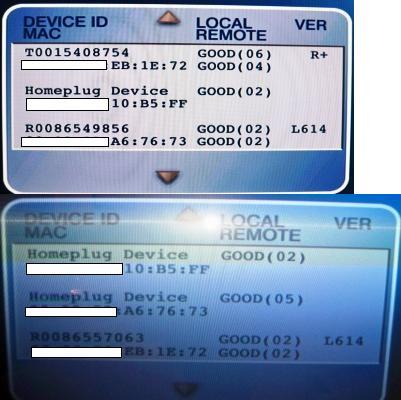

Ok, there's some weird stuff going on today. When I go to do the tests on each receiver, I'm seeing the three devices in the test, and then one of them will change after about 10 seconds. Never seen that before. It will change from homeplug device to something that starts with a T on the mac address and then it says R+ on the version. See attached screenshot.
Also, my broadband tests are failing today. I'm guessing it's a problem on D's end, but don't know if it's related to my issues or not.

Give at least last 2 hex numbers - .xx.xx of MAC.
T/R is related to a modem in that receiver what will be a hub, ie connected to phone or/and Internet.

Ok, here's a couple more screenshots that I took this evening. I'll chance the receiver #'s. Notice that the strengths are good now, versus poor before. Don't get why that's changing. Also, sometimes a device named homeplug will appear on the test, and after aobut 10 seconds or so change to a device with a MAC id starting with a T. Sometimes it doesn't.
