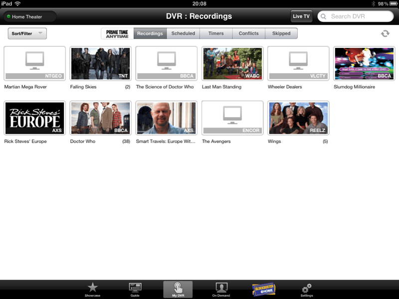

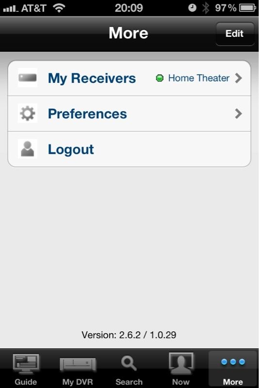

I recently upgraded to the Hopper, and I was trying to use the remote control functionality in the Dish Remote Access iOS apps. I have the most recent versions from the App Store for my iPad 2 and my iPhone 4, and iOS is 5.1.1 on both.
On the iPad, the remote icon is not in the top bar, and on the iPhone, there is no "Remote" item in the "More" menu.
On both devices, I can see my Hopper, I can see all my DVR recordings, I can set it to record something, delete, etc. so it is seeing the Hopper across the interwebs.
I've dug through the settings on the Hopper, and on my devices, but I can't seem to find anything that might affect this function. Am I missing something, or is this a "coming soon" function? :confused:

Mike, please tell me where you see the remote control in the DRA app? It is most definitely not on my iPhone app under the More menu like it was when I had the 722. I don't dispute that the app works for schduling and playing content with my Hopper, but the remote control application is most definitely gone (allowed you to pause, skip forward, skip back, etc etc).
Still no-go here. 221 software on the Hoppah, latest versions of the iPad and iPhone apps, but no option for remote control of the Hopper in either iOS app. I've looked into every setting I can find, but I can't locate anything on the Hopper or the apps to switch "on" to get it working.
I CAN see my recordings, so I know it is connecting to the hopper.
Do I have to set up something? Do I need a Sling Adapter? Something is missing, I just can't find what!
I am using DISH remote access on my home computer , not an I phone app on a mobile device. The play ,pause, skip forward, etc are on the bottom of the screen as you play the item. On the left side of the menu there is an ADD Recording feature and from there you can create a manual or DISH pass timer. The little stand alone remote control is gone on the menu. It seems to work more like the sling player app I saw using my stand alone Sling pro hd box, when I had that box.
