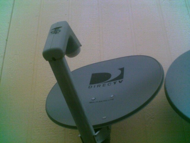

Attachment 1) Dish 1000 Pan with Phase III over it.

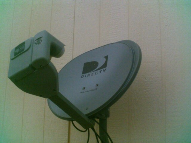

Attachment 2) Dish 300 Arm with Phase III Pan,(the holes do not match) running out of time to try today as I just got thru watering trees (12 Hours). maybe next week...
