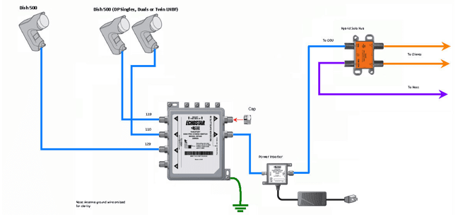

OK, he's not right. You probably have a 500 Dish w/DPP Twin LNB for the 110 and 119 and a 500 Dish w/DP Dual for the 129. You need a DPH 42 Switch and a solo hub. That's it. Run the 2 lines off the DPP Twin to inputs 1 and 2 on the 42 switch, line from the DP Dual to the 3rd input on the 42 switch.
Keep the terminator cap on the port 2 output, run 1 cable to the blue grommeted input (ODU) on the solo hub. Run the (Purple) host line to the Hopper 3, using the power inserter behind your TV. Cable goes into the power inserter (Switch side) out to the receiver. It's plainly marked. The hub can go before or after the power inserter.
Use the orange client ports on the solo hub to any Joeys you have. Unused Client ports need to be capped with a terminator. I comes with the solo hub

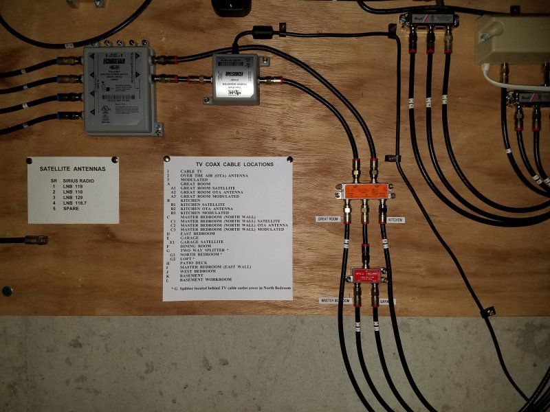

Dual Hub definitely works with the DPH42 switch even though it is not authorized.
