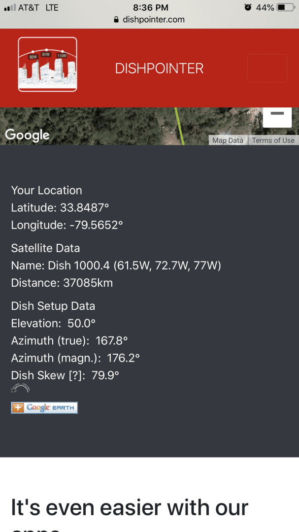

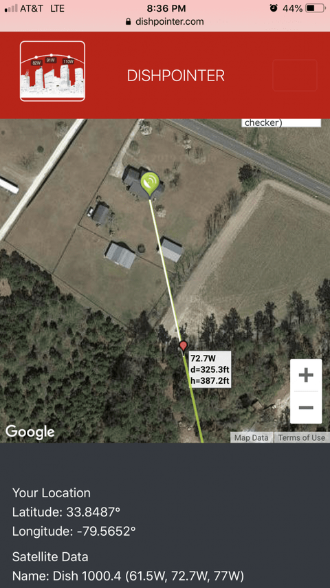

Here is where I want to mount the dish network dish for the eastern arc. According to the measurements the tree line should not be a problem. I would think the dish would be installed approx 5-6 above ground on a pole.
Does this all look good considering the measurements for height obstructions?? Those pine trees are about 90 feet tall.
