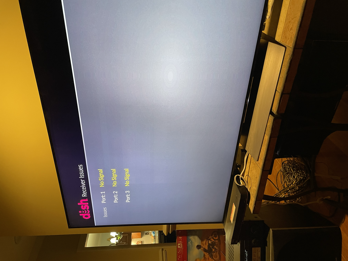

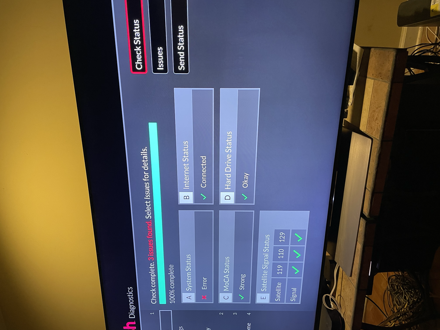

Hey gang, I just read through all of the postings for this thread. So my Hopper has no signal on the 3 ports up to the LNBs. Everything was fine Friday night... Saturday morning, complete signal loss. Googling this it seems SOME people have no dish tv service (Satellite), and I know of course the dish anywhere is out and the websites are out. Is this outrage actually causing the Hoppers to show zero signal? When I do a status check it shows green check boxes on that little matrix at the bottom under the 119, 110, (I forget the third one). but then says I have 3 issues... I click that and it shows ports 1, 2, 3 No Signal. I have to think this is related since nothing changed on my end, dish still looks good from the ground anyway... I do have an XR-3 at work that we use for Radio Broadcast C Band dishes, which does not have the module needed for Dish network, work, but it does give you an indication of how the dish is doing at least on 110. It didnt look like any of you have lost your actual dish reception. Please advise and I thank you all!

I have done that... it will do the checking for signal thing, then eventually it just stops with that "this should take no more than 5 minutes". Screen....

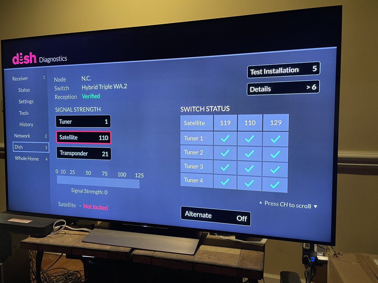

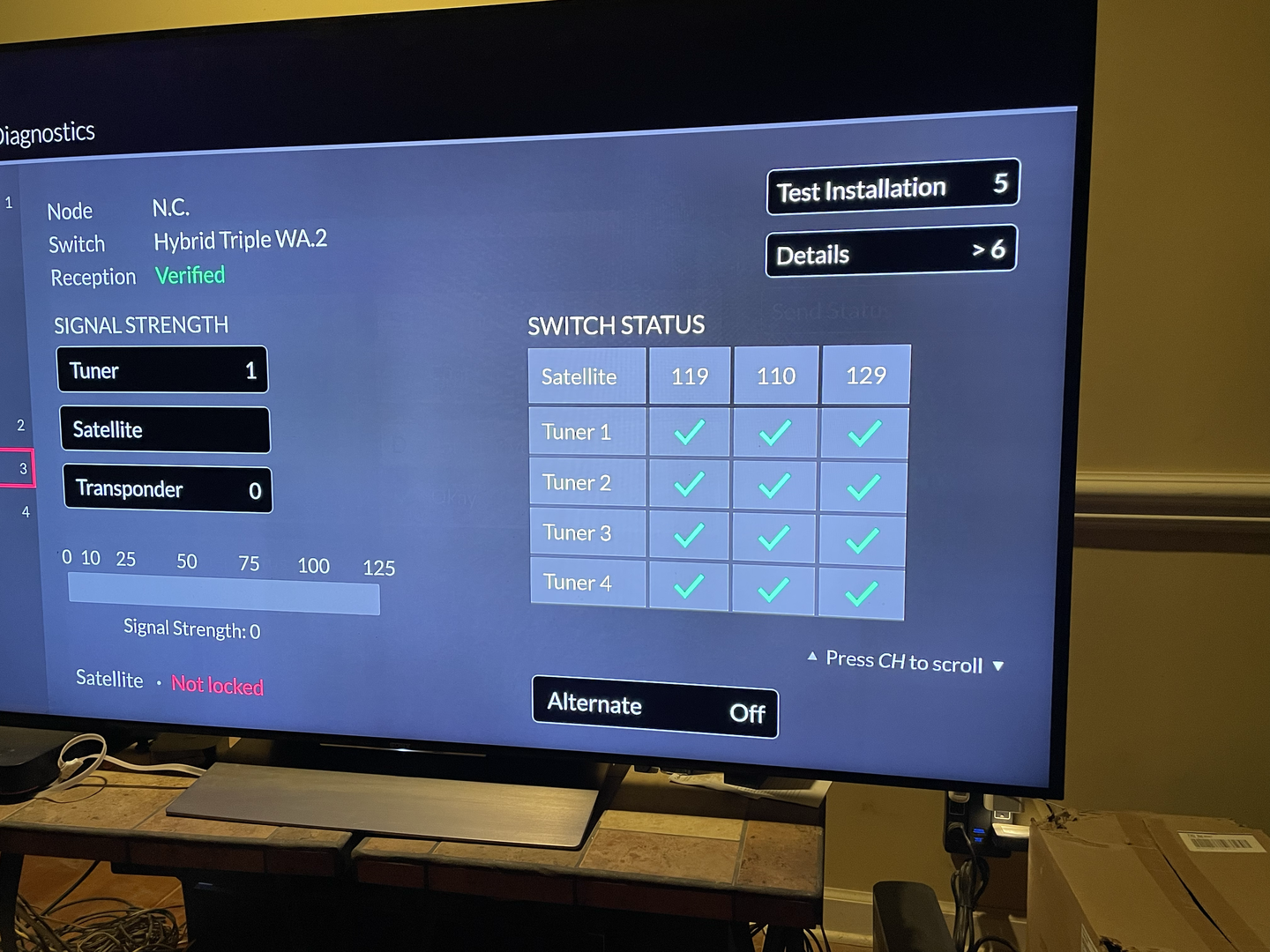

I can change to any tuner or any satellite transponder and it shows zero signal and zero lock... it was fine Friday night at like 10pm CST, then Saturday morning like 8am nothing....

Those pics were just now after unplugged for 2 mins and removed the RG-6 to the back, then I put that back on...

Switch Status is showing you the satellites it saw the last time it tested installation. Press TEST INSTALLATION. Most likely it will say "you have fewer satellites..." You can cancel or save at that point. The problem could be anywhere from the Dish to receiver.

The first pic showing Tuner 1 transponder 0 is what we call the 0 of 0 Transponder glitch. Typically, when you see that Tuner shows 0, setting it to 1 and backing out to where it says Acquiring Signal, that status bar will start to turn green and restore your service. Occasionally, we'll have to go to that Check Switch screen more than once and re-set Tuner to 1 and then back all the way out again
