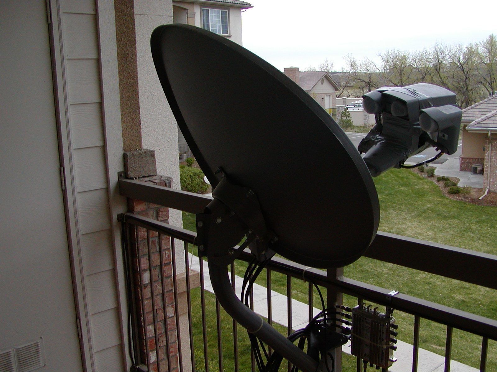

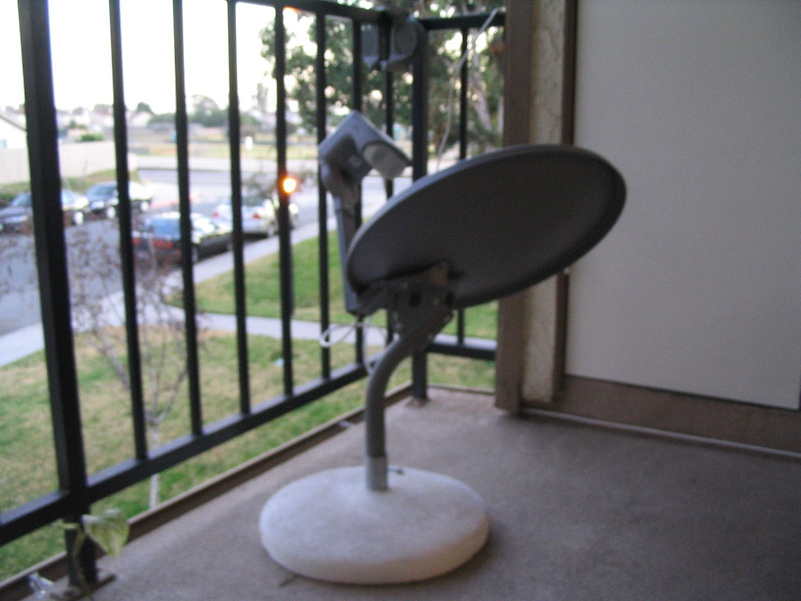

I am attaching a pic of the current status. It is on a second floor balcony facing south east, open skies etc. The thing that is bothering me is that the manual (page 120 in the link above) says the top part of the mast should be perfectly vertical. In my current configuration, the bottom part is the one that is perfectly vertical and thus it is not possible for the top part to be vertical as well.
One option I guess is to buy another metal pole, fix it onto the umbrella holder and then attach the mast and dish to this pole such that the top part is vertical etc. Is there any other way? Is it worth trial-and-error-ing my way through the different elevation and skew angles using the current config?
Attaching a pic to explain :) Thanks again for your patience and help. Apart from saving $30, it'd be great if I can do this whole re-install myself :)

I think they're blowing smoke. If you have exclusive control over the 2nd floor patio (called a "balcony" where I come from), you are free to attach the dish to the railing unless it will permanently damage it or cause a threat to the structural integrity of the building (or some part thereof). Nothing is going to be as stable as direct attachment. I have had dishes set in cement in large buckets get blown over. I haven't lost an LNBF yet but it does require repair and reaiming. Tripods are useless in most areas unless you get the kind that uses 6-9 cinder blocks as ballast and even then I have seen dishes skitter across a patio. Don't underestimate the power of wind on a sail (aka a satellite dish).

- You do not need to mount the dish on the mast that it came with.
- You can put a 1 5/8" pipe into the cement.
- Flatten the bottom of the pipe, or put a bolt threw it, so that the pipe will not turn in the cement.
- Hopefully the balcony is not on a slope. If so, then pour the cement and level the pipe, while the cement is curing on the balcony.
- You will probably need some sand bags to keep it from moving in light winds.
- Assuming your balcony extends outwards on both sides, maybe you could run a couple of landscaping logs from one side to the other and just set them between the railings to help stop the dish mount creation from moving.

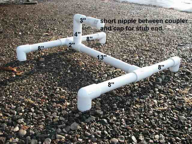

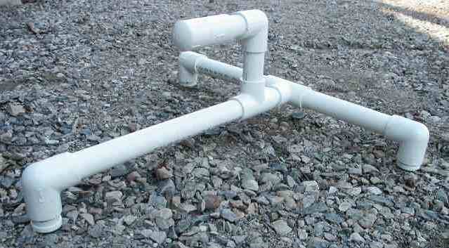

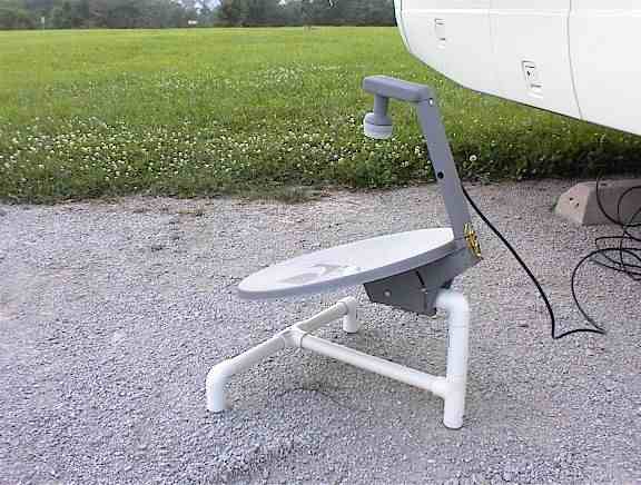

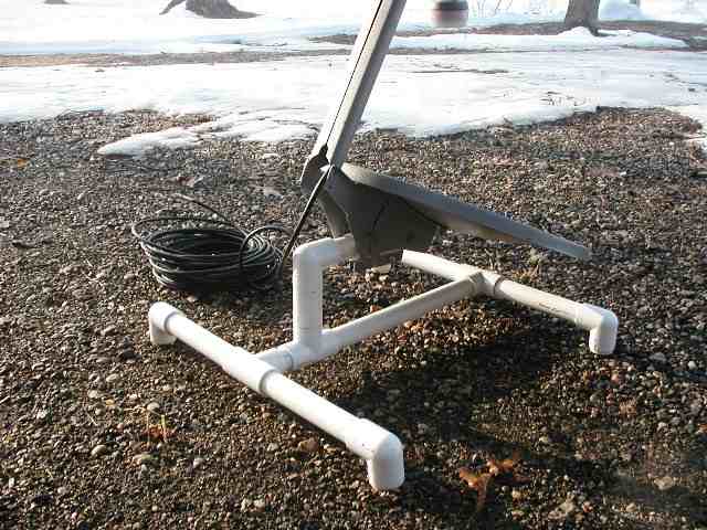

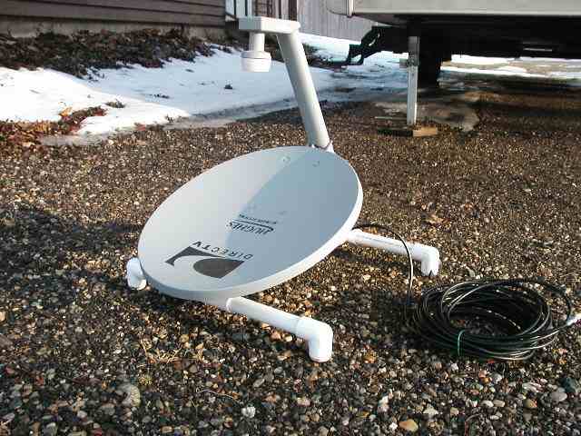

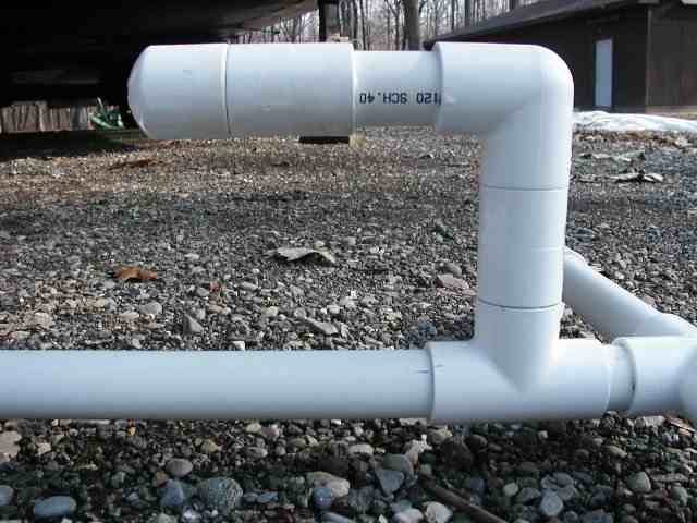

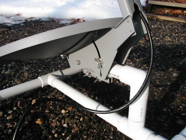

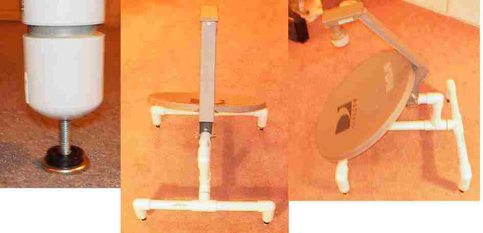

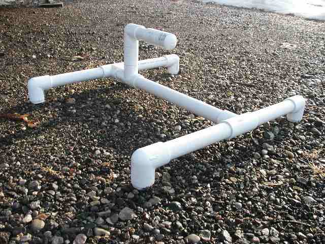

Maybe try a low-profile mount that will reduce the wind area.
Here are some more pictures - of a 3 legged, and a 4 legged mount.
I think the additional pictures came from a thread on this site, but I don't really remember, but am sure someone may recognize it and be able to furnish a thread to it.
EDIT: Maybe you could make a low-profile mount and mount it permanently on a table next to the railing.

I think his sunbrella mount is a good idea, he just needs a straight pipe..... It's the same as a chain link fence post, hardware store, $4. Cut yourself off about a 1.5' piece and do the same thing you have there. Leave the skew and elevation alone and rotate until you get the best signal.
Fill the thing with water like it's supposed to and perhaps sit it on a rubber mat so it won't slide.

Thanks everybody again. I am leaning towards getting an additional pole, attaching it to the umbrella stand... that way all I need to do is make sure that the top part of the mast is vertical and the same elevation/pitch angles should do the job for me.
The cement base feels heavy enough that I think it will not move around much... I live in San Diego :) so not too many storms here.

Yea, I was thinking about the sunbrella/umbrella stand being too low and blocking too much of the signal, but then thought maybe for his location he was getting his signal from high in the sky.
He has vines on the patio and leaves on the trees.
I think maybe the sunbrella/umbrella on a table if he needs more height.
