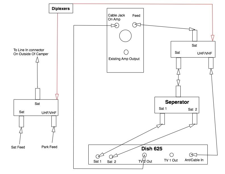

Thanks for giving the additional info for GaryT. If he were using Svideo or A/v to connect the 625 to his set then cable feed could be taken to the TV on coax was the reason I asked that. Ok well first suggestion I would make would be to check this link which gives pretty clear instructions on how to rewire the Winegard wallplate to make the install neater and also allow for easy feed of the TV2 signal to an additional set in the camper. http://www.tv4rv.com/wiring.pdf As to connecting the park cable and sat on the same wire here's a quick and dirty drawing that I hope makes that portion clear for him. The attached drawing assumes rewire of wallplate as per above link and that you feed main/only TV directly from TV1 out on the 625 and that you are back feeding a second set if it exists using the modified wallplate. Didn't have very good drawing tools here at the office so hope this is clear. If not give me a shout and I'll make a better drawing later from home.
