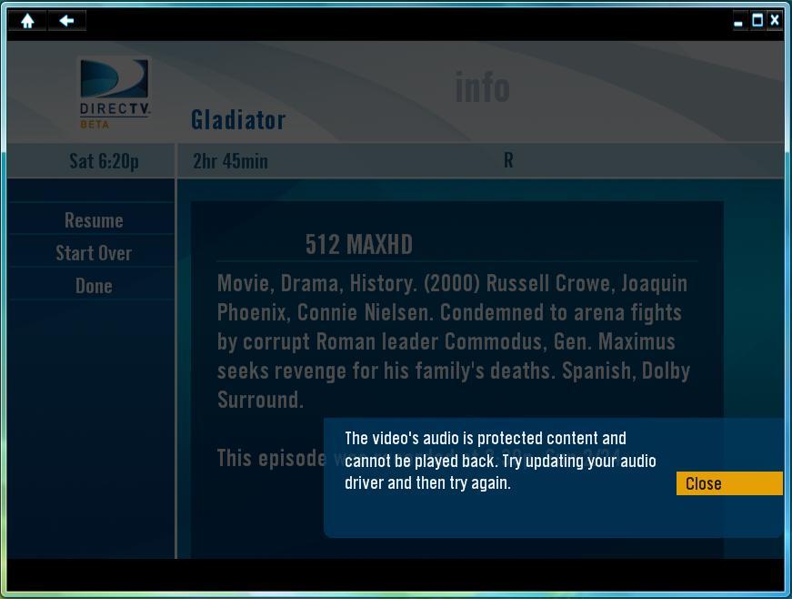

Video's Audio is protected content
Does anyone is getting this error?
"The audio's video is protected content and cannot be played back"

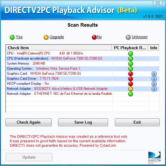

I did a fresh clean install of Windows Vista in my computer, and in some movies I'm getting that error. My drivers are updated, Win vista has all updates available. I tried removing my sound card an using the one integrated in the motherboard, but same result.
If I use my laptop, I can play the movie with no problem.
I'm attaching a screen shot of the error and my configuracion.
No, but I can see the advisor is recommending you update your driver set on at least one component; maybe you need to do this across the board for all components; as well as making sure your mobo has it's latest firmware.
According to the advisor results, you are not HDCP compliant, therefore this particular machine will not play HDCP content :(
I am geting the same error and all my config is green. SOme content plays fine but I havent been able to get the VOD that I downloaded to play.
I'll upgrade my video card and CPU, anyway I want to leave this PC as a media center with blu ray. I'll post my results.
Thank you.
Weird thing is that the content is not VOD, its recorded from Cinemax, and I can play it in my laptop. In this PC it plays for about 1 second and then I get the error message.
