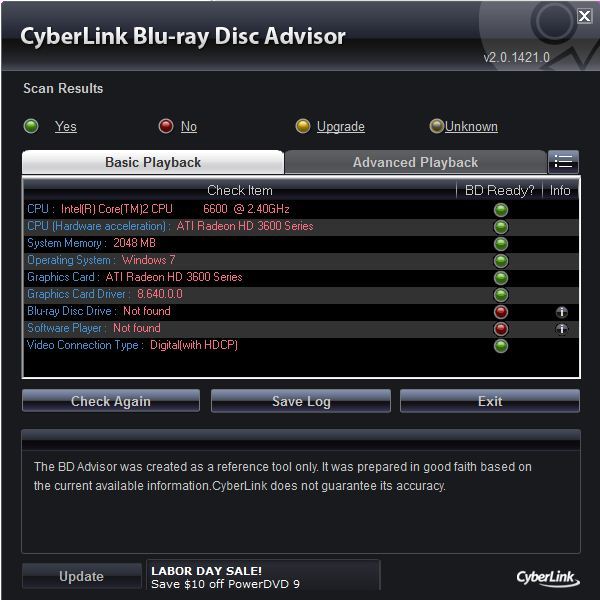

I have a Dell 24" DVI monitor. I don't think it is HDCP but my video card is. I have found the best test for HDCP compatibility is to download Cyberlink's BD Advisor. Lots of Nvidia PCIe cards say they are HDTV ready when they aren't. They must have an HDCP chip on board. I finally switched to ATI cards for both an AGP box and my PCIe box.
I learned all this setting up an old P4 board to stream Netflix. It just skates by being BD capable. It even passed 5.1 sound. It streamed Netflix great until I went from XP downgrading it to Vista. Now Netflix is jerky and I lost 5.1 on media that support it. Vista Media Center forced a Silverlight install which may be my Netflix problem.
Sorry I wandered off topic a bit but Microsoft's DRM and HDCP are a nightmare. HDCP must be present in every link of the chain or it will fail. BD Advisor will tell you which link is broken.
Attached are my BD Advisor results. As you can see I pass HDCP but can't play BD's as I don't have a BD drive or BD software on my PC.
