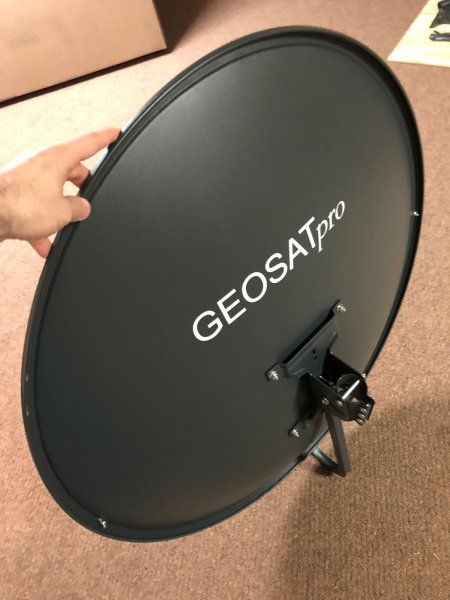

Setting up the Geosat dish now. Do I use the 20-50 degree elevation range or the 50-90 degree elevation range?

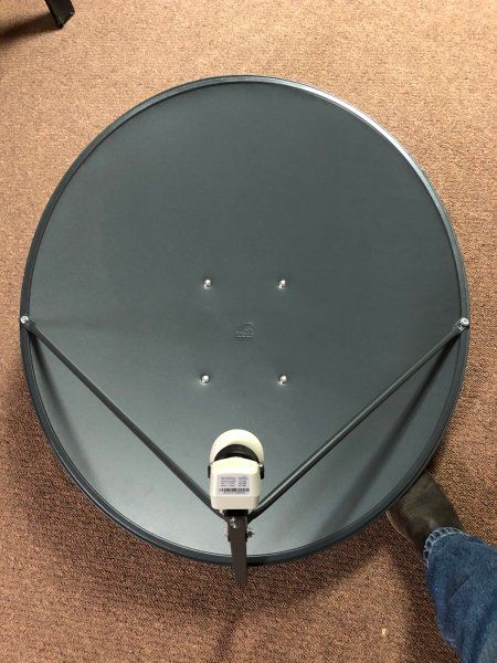

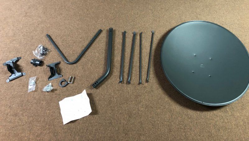

I've got the dish put together. Used this Youtube video for guidance:

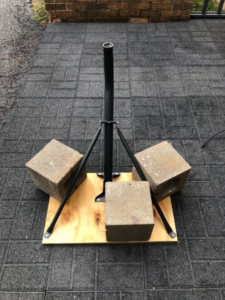

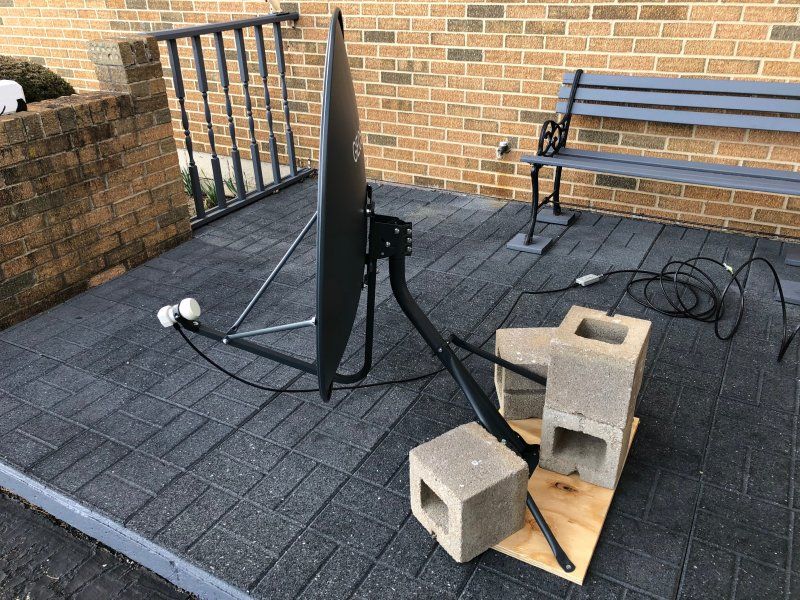

Tomorrow I'm going to cut a piece of plywood and mount the foot, mast and wings to it, then put cinder blocks on top of it as a temporary rig.
Once I get my rig outside, is there a resource that will tell me what elevation I need for 103 at my location? Also how much offset on the LNB (if needed)?

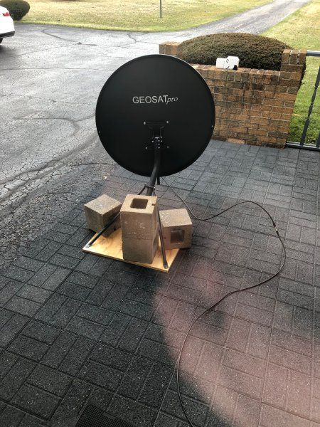

So today I mounted my dish to a temporary outdoor rig. I hooked up the signal meter in-line with the Amiko, used the Dishpointer app to get an accurate elevation and azimuth. So far, the signal meter beeps and displays "98" all the time, regardless of where the dish is pointed, so I think I might have a dud meter?

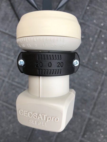

I'm also confused on the LNB skew. There are numbers on the holster, and numbers on the LNB itself. If it says I'm supposed to rotate the LNB to 21.6, is that using the numbers on the LNB?
Needless to say, the first day didn't render any kind of signal, but it's only Day 1. Back at it tomorrow.
Some people spend their vacations at the beach, I'm spending it on FTA :)
Reactions: danristheman
I was thinking the same. Also: Yeah those cheap meters aren't good for much, but a reading of high all the time sounds like you are aiming too low and picking up terrestrial noise.
Don't mean to butt in. Look at the pickets and mortar joints in the background. He may have too much angle. Also, the lnb looks to me like it has too much angle. Just my 2 cents.
