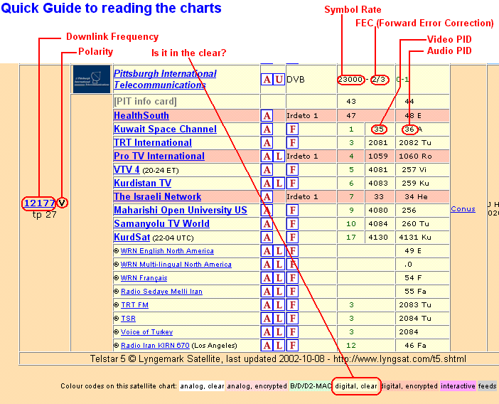

ah, thelist makes much more sense to me. On lyngsat, where do they show you the symbol rate?
it is to the right of where it says "DVB". See attached picture
