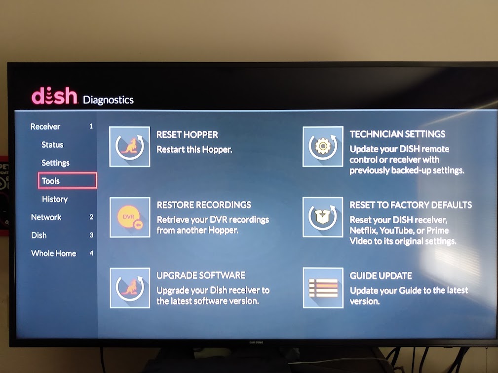

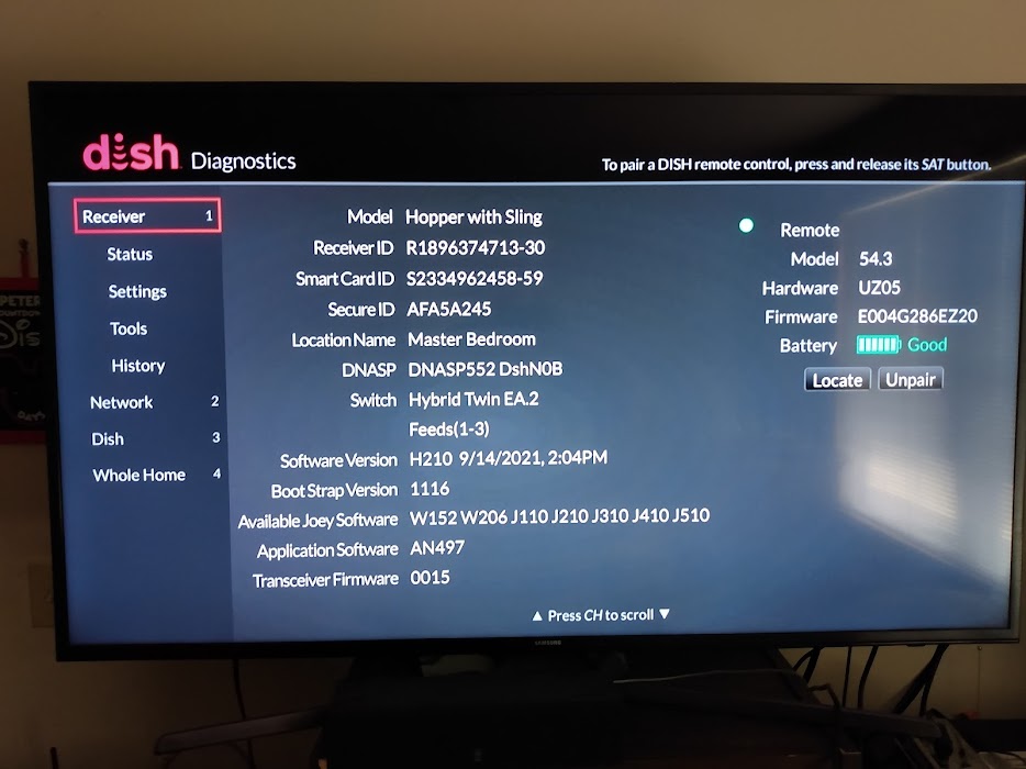

A bit of good news. I called Dish Support this afternoon to at least add to the list of annoyed customers. The technician noticed I was still on software H209. She suggested up upgrade my software to H210 and see if that solved the problem. DVR functionality has returned for me on WJW FOX 8. I was even able to record and view a program today off that channel.
Press the home button three times to navigate to Dish Diagnostics and select 'Tools'. UPGRADE SOFTWARE is at the bottom left (sorry about the glare but the blinds were closed). I hope the software upgrade solution works for you. The upgrade took more than 30 minutes.
