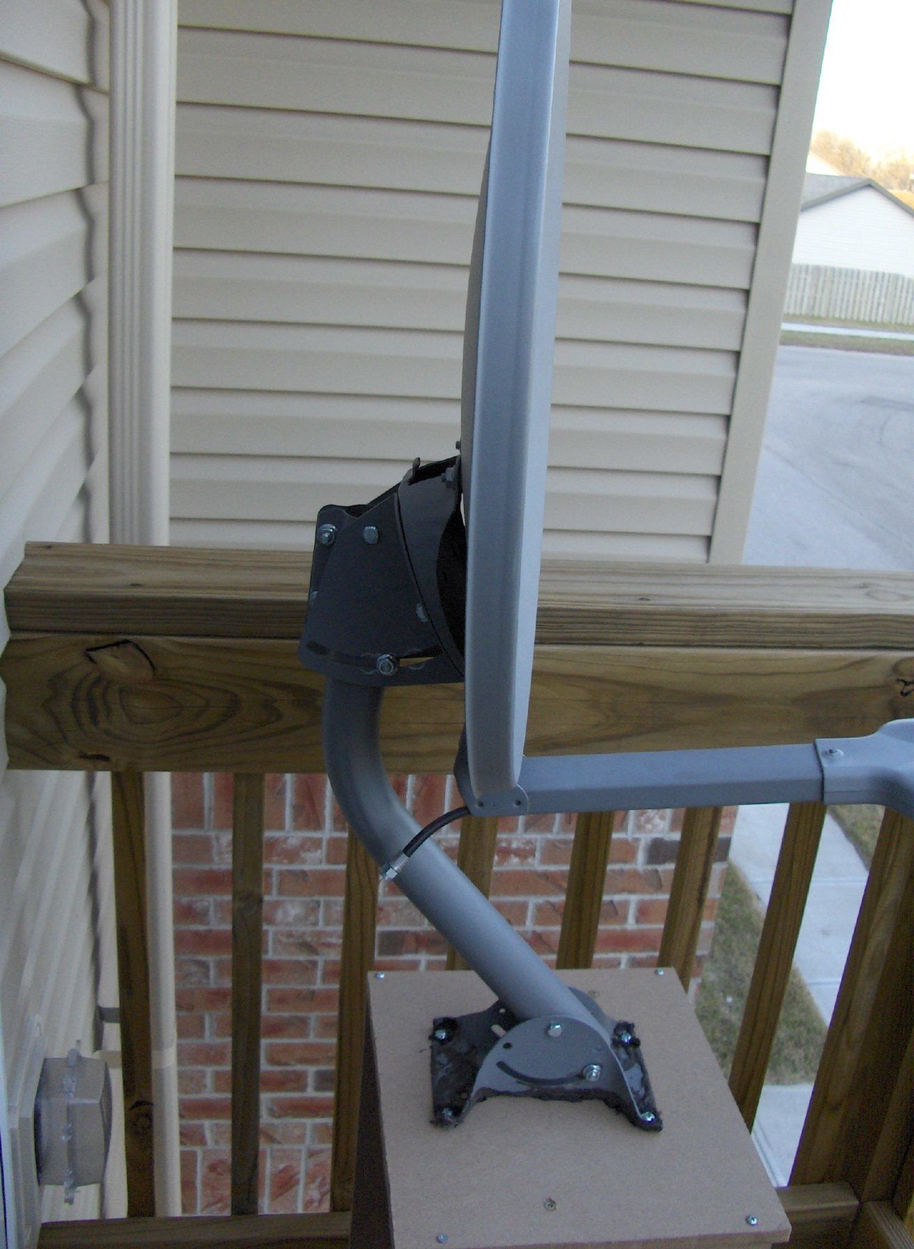

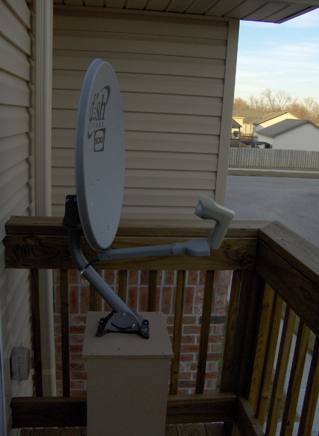

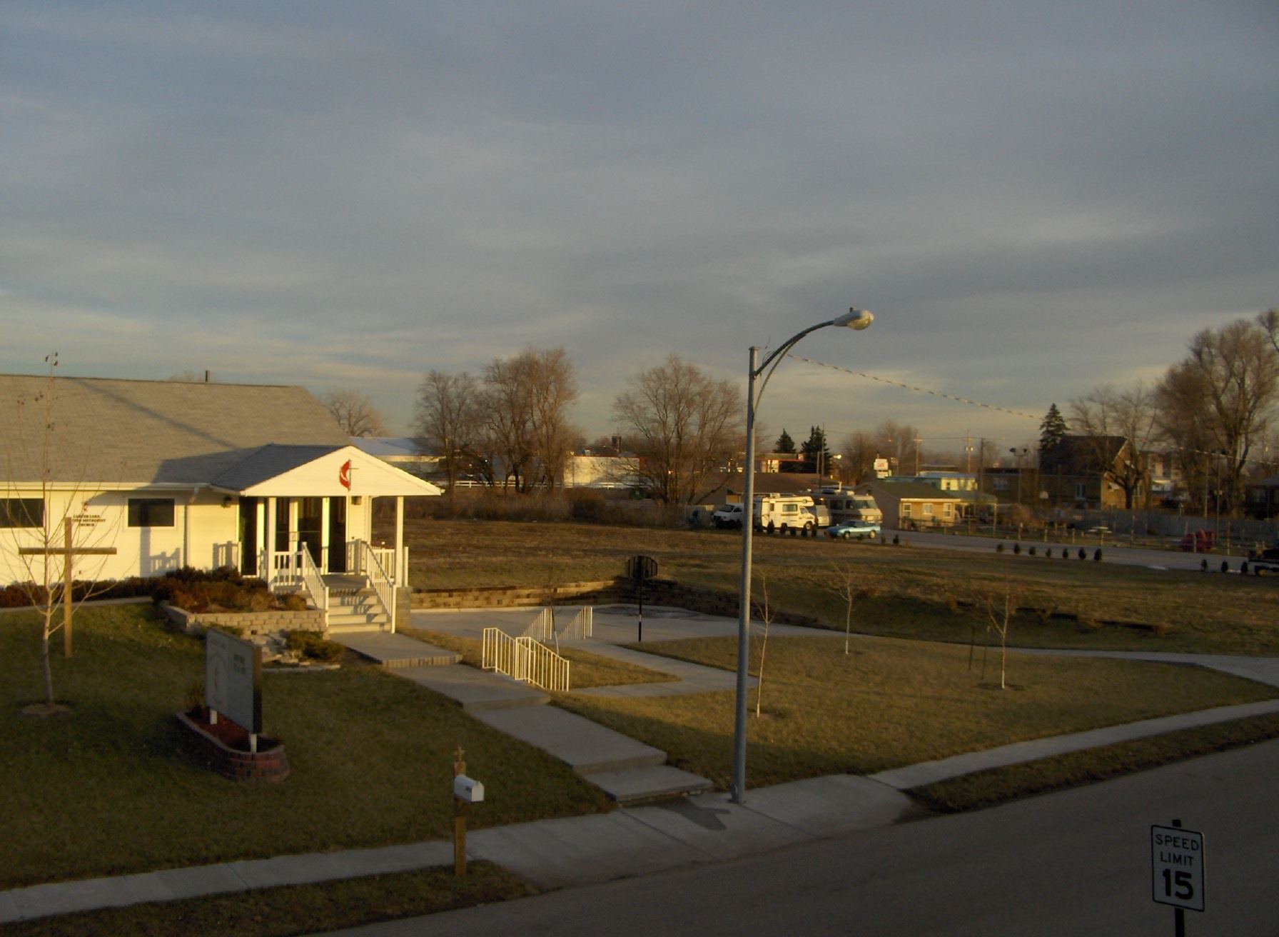

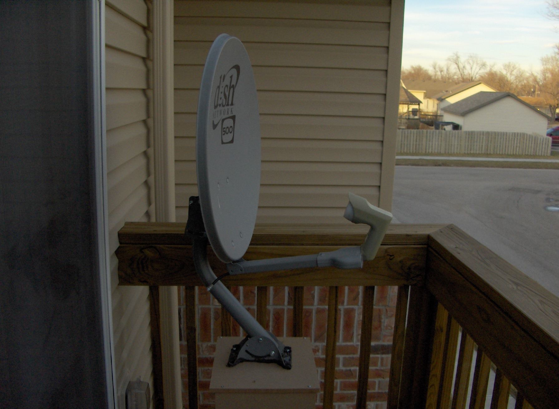

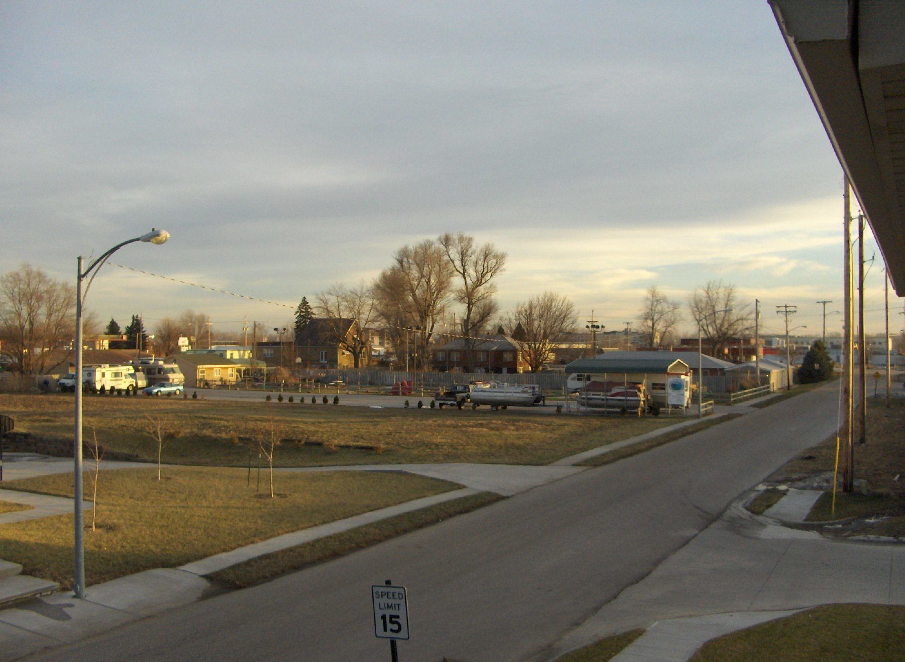

Here are the pictures. Let me know what you think.
Thanks again,
Le fou

Ok so you do want 61.5. Sorry, I was the confused one.
It's hard to tell from the pictures but it looks like the balcony or the structure above the dish might be blocking the satellite signal. The signal comes roughly around 20 degrees higher than what the dish is pointing at. You will need to move the dish so it can clear that balcony. Try putting that stand horizontally, that will lower the dish and might help clear the balcony.
About 3 yrs. ago I had a similar setup when I was living in an apartment and I had to lower the dish so it will clear the balcony above me.
Let us know how it goes.
also you have the dish backwards, turn it around and thent he stand as well, the settings you have it set wont matter because the dish isent facing the right way/angle,ect on the mast
That is not a problem it will work either way.
If the dish in the pics is pointing at 61.5, I can't see any problem getting 110/119.
Any building next to yours should be far enough away - unless it's much higher.
As already posted, remember the signal is actually coming from the angle of the elevation NUMBER, which is 22 degrees higher than where the dish pan is pointing.
