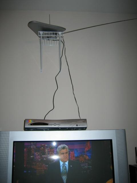

Hey Guys,
I am now vooming at my location.
Tried to purchase Zenith Silver Sensor, but could not find it anywhere where I can buy it locally. So I head over to Walmart to see what they have. Can you believe ..been over at Walmart again .. 3 days straight.
The Voom I purchased came with Winegard model GS22VDR. Hooked it up, I could only manage to get 2 channels. Hmm, I WANT Fox for superbowl.. not good.
So I hooked up Philips Amplifed Silver Sensor antenna(PHDTV3) for $35(inside has silver sensor built in). Received over 13 channels. So far so good..
One minor problem. I can't get all major networks under one antenna setting.
I can get NBC,ABC, and FOX, but I have to move the antenna little to get CBS, TBS, and UPN. I wish I can get all these channels without moving antenna around.
Thanks everyone for your suggestions.
dodge said:
Cool
Thats great!!!
you must be outside Atlanta somewhere to get TBS
Try the Winegard Sensor in the attic it would probably work well for you!!
Alrite, I will give this try also and post the update. First thing first, need to find me 50' ~100' cable. :)
