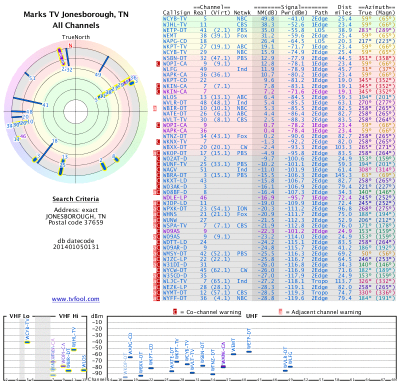

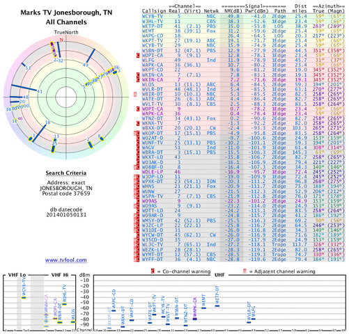

Hello,
My tv fool report below. Can I use a combination UHF / VHF for this setup? Need suggestions on which antenna and amplifier to buy. THANKS!
Hello,
What is the question you are asking you need both VHF and UHF. You can use both a combination antenna or separate UHF and VHF HI. After looking at www.antennaweb.org You need both VHF HI and LOW TVFool shows 5 and 27 NBC with the same call letters and same broadcast location, Antenna web only shows ch 5.
Any recomendations for a VHF HI and UHF combination ? Do you recommend a seperate booster, if yes what kind ?
Thanks
He really wouldnt need VHF LO
5 is the original station but they have a translator on 29 at the same location. Since it shows decent numbers on the tvfool he could use that instead
That changed, before the transition deadline 5 was broadcasting on 28 uhf. They are on 5 vhf now.
I stand corrected, you're right............5 is on 29 uhf. Wonder when it changed?
