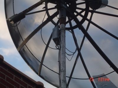

Maybe tomorrow, I'll post some pictures close up of my 10' BUD. I have had a long day, and am too tired to take the pictures now.
I have never let you see it close up for fear that you would laugh at how bad it looks. You would have all told me that it would never work, but it does, and works pretty good too I might add.
The key is in the focal distance, the f/d ratio, and perfect alignment in the center and on the arc.
If it hadn't been for you guys, and your suggestions, it wouldn't have worked, but I will let you see all the defects tomorrow.

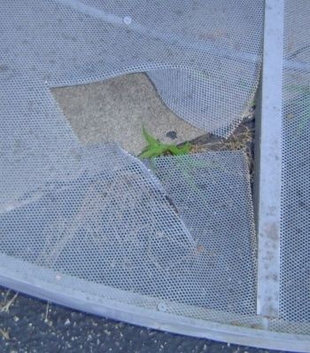

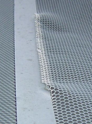

For today, here are some pics that I took when I first brought it home. This doesn't show all the hail dents in it. I repaired the tear, and bent back the holes for the most part, but there wasn't much I could do with the hail dents, but it performs beautifully anyway.
Tomorrow I will show you what it looks like now.

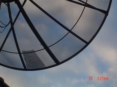

Well here are the pics that show all the blemishes on my dish and the patch I put on for the big tear.
I tried to flatten out the hail dimples, but it is like trying to take out the hail dents in your car fender. They just don't flatten. I did manage to close some of the little holes up by using a hammer and a piece of flat steel to mash against.

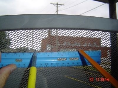

Here is a pic that shows the hole sizes. The specs on the dish say they are .110 x .150 diamond shaped holes. The pencils are #2 size, and as you can see on the yellow pencil, the lead does pass through the hole. hole-size.jpg
I can't account for why it performs so well except to say that I spent a lot of time tweaking and peaking every aspect of alignment. :D

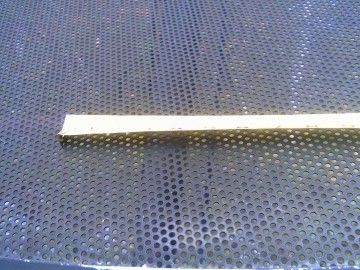

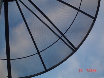

Perf aluminum dishs are made from aluminum sheets that have been perforated, not from a wire mesh. I have attached a close up pic of what it looks like.
