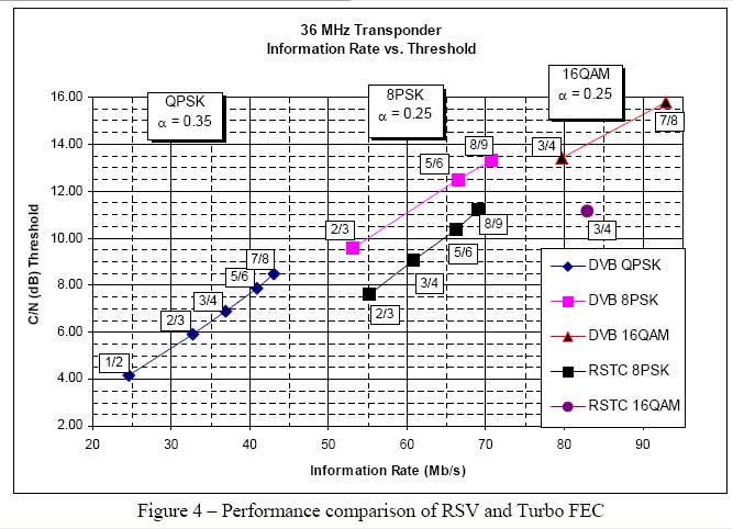

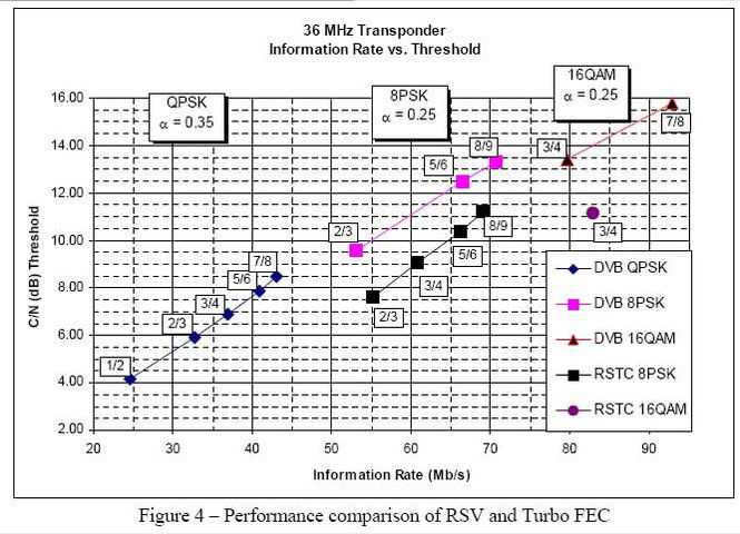

21500 baud (symbol rate) on 118 is QPSK and 129 is 8PSK which can through put a higher imformation rate
21500-2/3 QPSK (2 bits per symbol = 42,000 Kbps times forward error correction = 27.9 Mbps
21500-2/3 8PSK (3 bits per symbol = 63,000 Kbps times forward error correction = 41.9 Mbps
21500-2/3 8PSK Turbo can reach 54Mbps
http://www.sciatl.com/products/customers/white-papers/BCA-2002%20Ken%20Hanna.pdf
