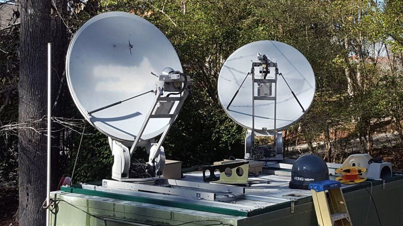

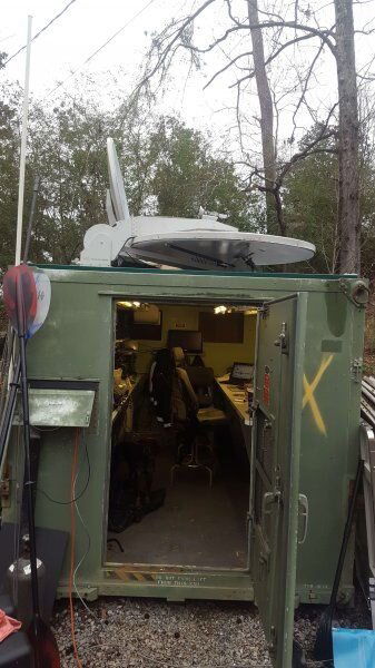

Update on this,.. i mounted the dishes on a Military S-280 Shelter and built the inside as a Radio Room, the shelter will either go on a M-1061 trailer or the back of a Military 5 ton (although im concerned about height of the 5ton with it)
I used Uni-Strut to build a frame on top of the shelter, then bolted the dishes to that. One image shows the dishes deployed, and the other show one down in storage, plus the inside of the shelter
