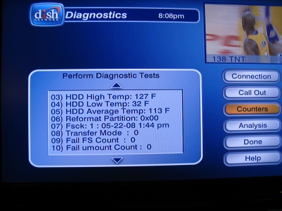

Here are the 612 temps:
Bedroom TV - High: 127 Low: 32 (yes, that is what it says) Ave: 113
(The bedroom is where the problems were the other night; OK, bring on the jokes!)
Living Room TV - High: 125 Low: 111 Ave: 116
And for you voyeurs, here is a pic of the 612's diagnosis screen in the bedroom:
