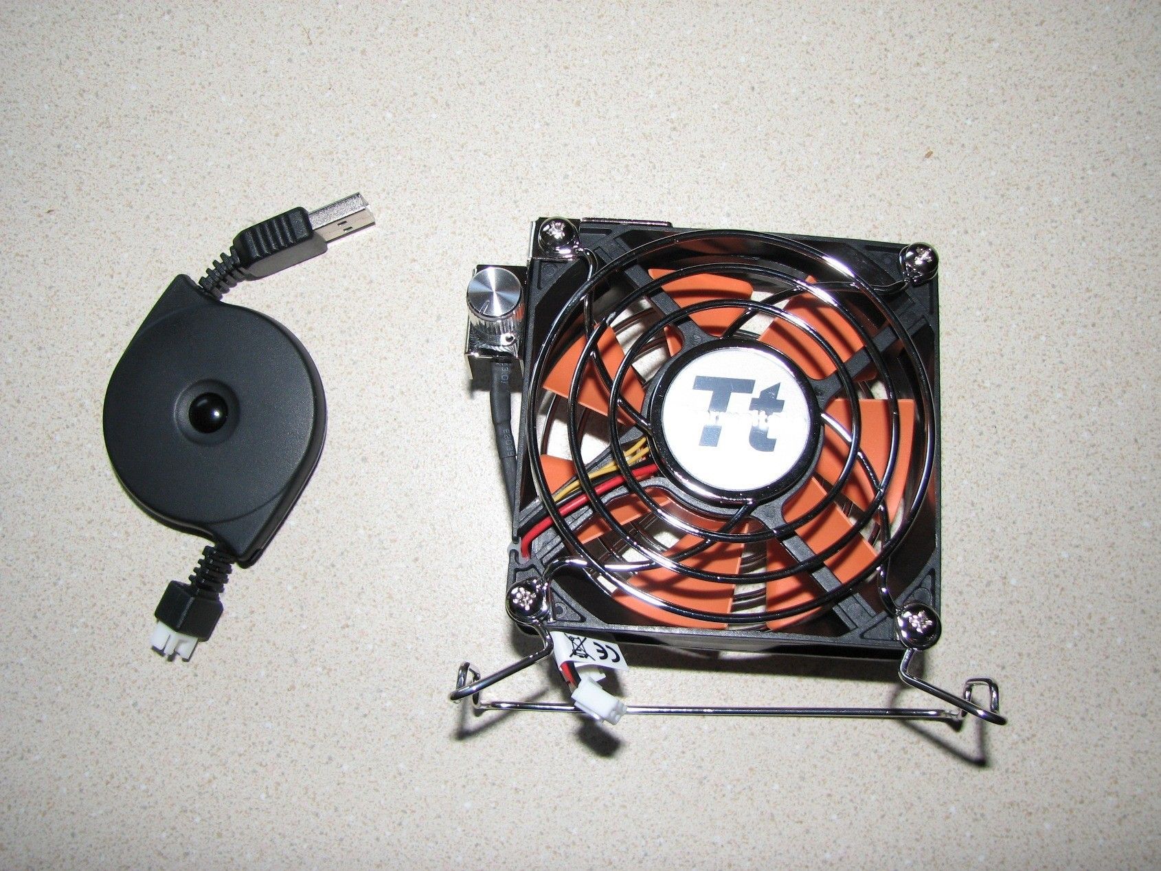

My avg temp is now up to 125, just got this little guy today and put him to work:
Quick question. On the left side(facing the 722 front) there is a long row of vents, but only two square holes inside the vents(one near the front and one near the back). What is the heat source more close to, the front or the back and should I use to fan to blow air in our pull our out?

The power source is at the back on that side, but from what I have read, the hard drive or broadcom chips are the big heat source, they are more toward the center of the case. I coud be wrong.. I had the same fan set up on my 622, I put tape around it to seal it and make better air flow out, had it at the power source. I now have a 722 at that location. I put the 622 in a bedroom and now the fan is not being used on either box. My 722 is showing 120 degree average, it has creaped up slowly since I installed it last Sept.

Ah, thats dumb that they put them in the middle with no opening. Well, maybe I should be cooling the PS then.
That fan only took my 622 temp down 4 or 5 degrees, what really helped was a 6" fan blowing air into vent on right side of box along with the little one sucking at the ps vent.
My thermaltake usb is mounted at the rear of the left side centered over the back hole. Looking at the pictures, this should be drawing ait from inside the box across the PS and then out.

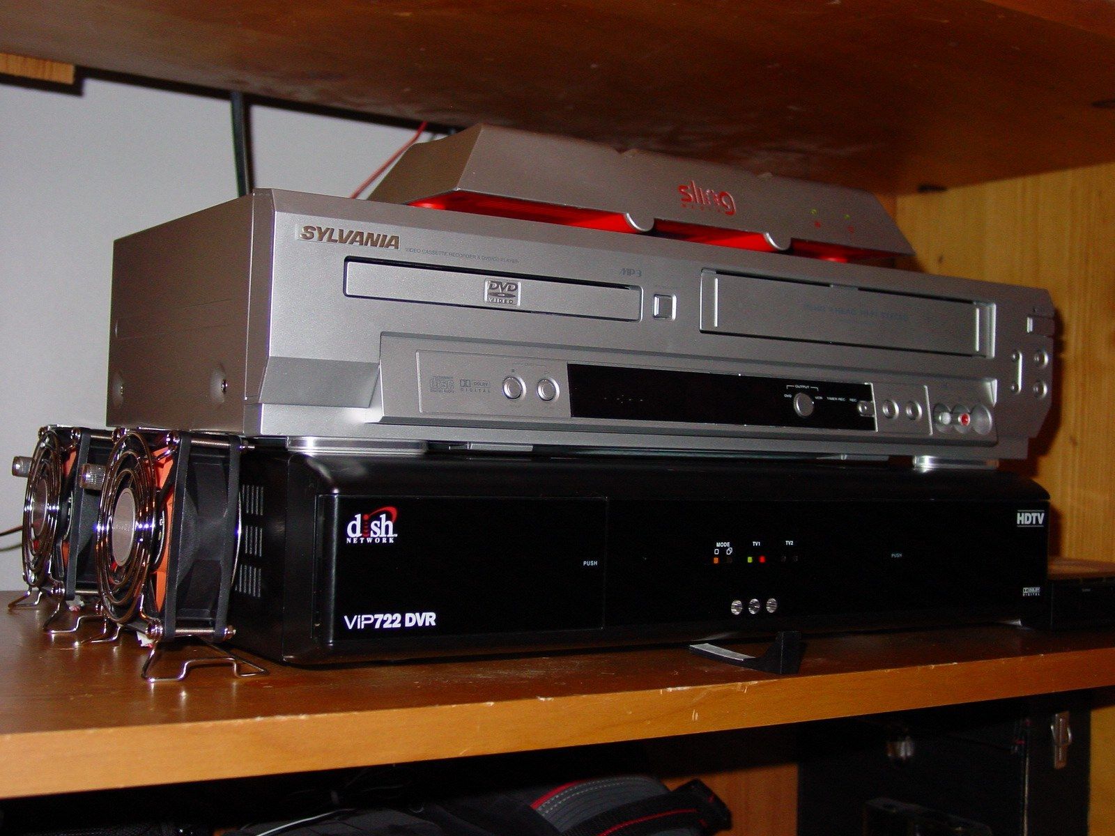

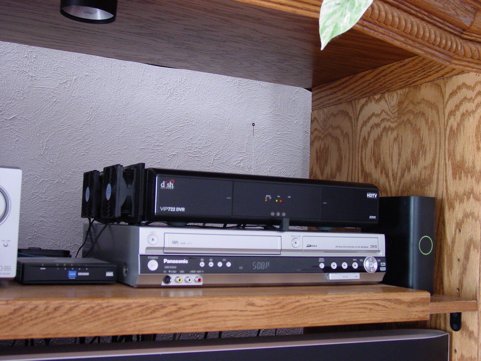

Temps are still coming down on two VIP722s. Did another configuration change of fans today. Going to leave them alone now and see if temps come down some more. Bottom line is one 722 has a Dish VIP 622/722 Cooling Fan System installed and the other 722 has two Thermaltake Mobile Fan II External USB Cooling Fans installed. All fans are mounted on the left side of the case at the exhaust vents sucking the hot air out of the 722s. I sure hope the new VIP722k (or whatever it will be called) has a better cooling system. Check out the attached spreadsheet for temps and web sites of the fans I am using.
