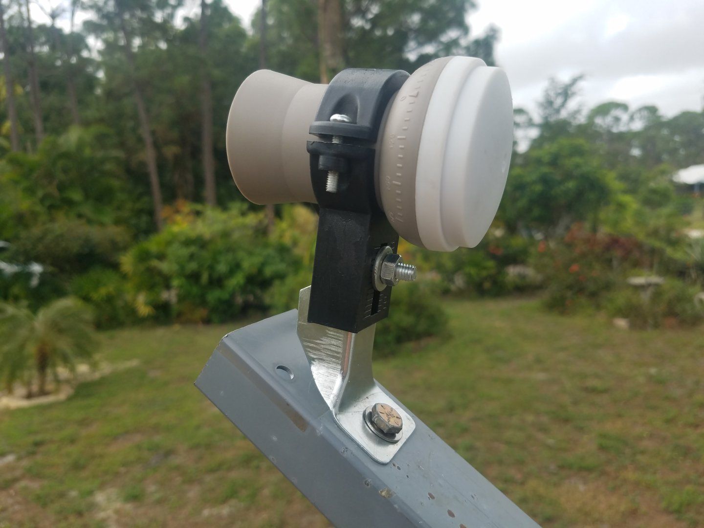

I clamped the LNB on the arm and tried to get it to match your numbers.
The best I could do is 19" and 26 1/4" or 20 1/2" and 27 3/8", in other words when I got one of your measurements right, the other was off. The single hole next to the two mounting holes you mentioned measures 21 1/8" and 27 3/4" . That is where my LNB is mounted in my original picture from post #1. This dish originally had 3 LNB's. Every time I think of how I dropped them in the trash can it makes me feel sick!! :oldfrown

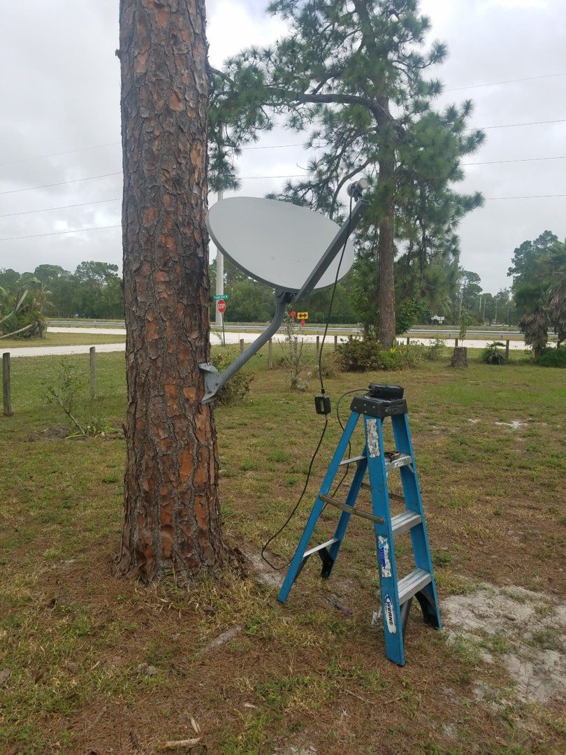

I know that everyone here has their method of finding a satellite, but I just wanted to update my progress and explain how I did it. It might just help someone who is new to this hobby someday!
I leveled and mounted the dish to the pine tree. I left the elevation as it was when it was used for Dish Network. I guesstimated the LNB position/skew and clamped it on with the spring clamp. I hooked up the tone meter and swung it west. Got a loud tone at what turned out to be 121 degrees west. Normally I would do a scan to see what satellite I was pointing to, but Dish Network told me on their test screen. "You are viewing Orbital 121 test screen." This satellite happens to have two transponders with the same or close to the same frequency as 97 west, which was what my meter was set to. I then tweaked the LNB position. The optimum spot turned out to be where I had it in my picture at post #1 of this thread, 22.5". I originally determined this by using the formula, f = ( D * D ) / ( 16 * c ) I was surprised that the formula worked for a dish like this. I used the widest diameter for the formula. The position happened to be the first single hole from the end of the LNB arm. The location of the LNB appears to be very forgiving.. a half inch either way had no affect on the signal. Knowing which satellite I was on gave me an idea as to where I would have to point to get to 97 west, so after raising the elevation, I eventually hit my target satellite with a decent signal of about 60. I did a scan and got about 120 channels using the portable meter. This will more than likely increase when it gets connected to a receiver as will the signal strength. It did the last time anyway. I think I will try adjusting the skew by rotating the dish. This will allow the RG connector to point down and be more out of the weather. I don't know if doing that will affect the signal strength though.

Glad to see you got it Doorguru! However, I would consider dropping a pole and concrete in the ground. That tree will give you years of grief. Will keep you tinkering though. :)

Oh, this is temporary just to set the focal point and see how good of a signal I can get with a dish like this. It is probably the only place on this property that can see the horizon without having to install a pole. I will remove it from the tree and try to find a permanent location for it. Then point it to another satellite and use a diseqc switch. I already have 97W with the dish shown in my avatar.

I was using the spring clamp so I could slide it all along the bracket and that position that I chose was as good as it got and I already had a hole drilled, so I bolted it down. If you read my previous post you will know that I could not make those distances Brct203 mentioned work. He also mentioned in his post that the same first single hole from the two original LNB monting holes was the focal point that he used previously on the dish pictured in his post.That was the position that worked.

As far as the LNB height itself, none of the pictures shows it, but I dropped it about an inch lower using the up and down bracket adjustment.
Look at this picture from post #1. The arm is sitting pretty low. I tried sliding the LNB back and fourth from the dish and even tilting the LNB down. The signal never got any better. This is how this dish has always worked, even when it was Dish Network. Has a strong signal now and did back then.
