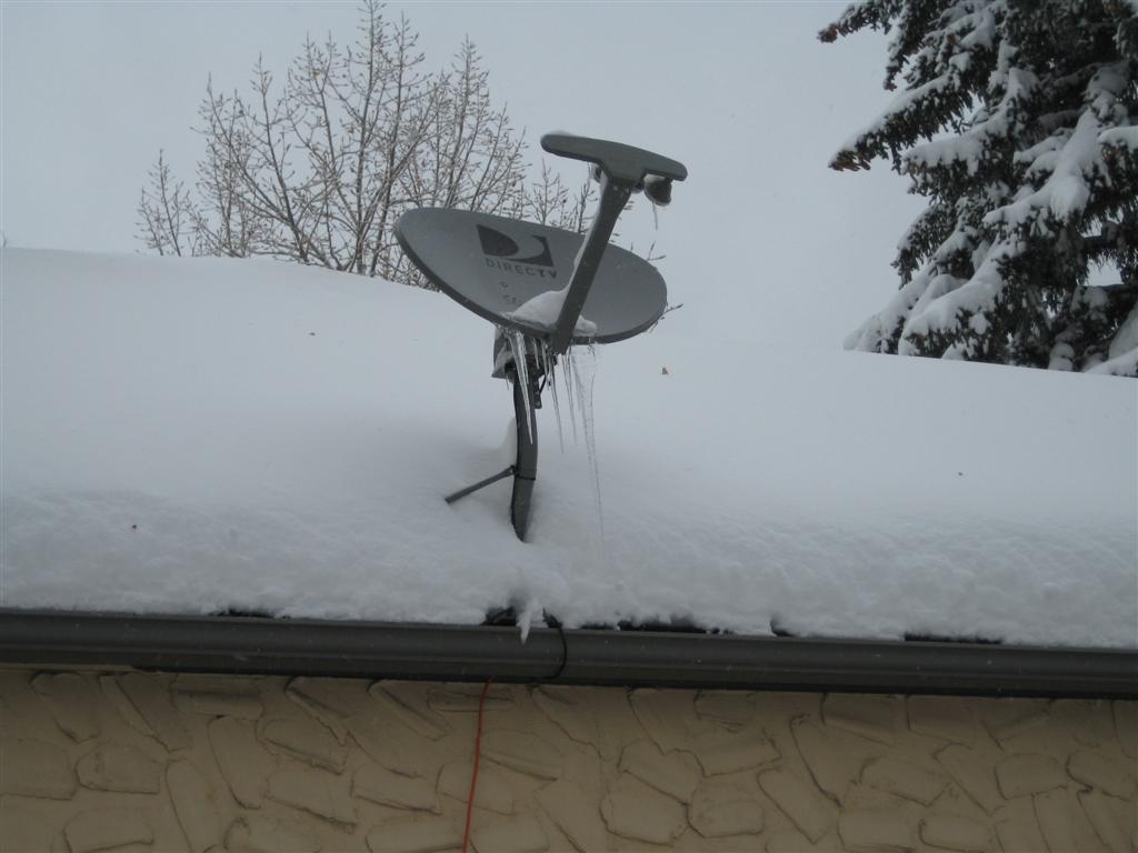

Last night out first storm came in and I lost the signal when about a quarter inch of snow had stuck to the dish face. Plugged in the heater and got the signal back in less than 3 minutes. I got the model without the thermostat and just plan on turning it on when I need it. I plan on hooking it up to a plug with a switch inside so turn it on when needed, maybe a timer, but on days like today when it is going to come down all day the timer might be more of a pain that it worth. I have attached a couple of pics from this morning, we got about 3-4 inches of snow overnight and the temperature is right about 30 degrees. I am interested in seeing how it performs once the temperatures really drop, although at temps where I think it might have problems keeping the dish clear would be too cold to snow. Just wanted to relay my experience so far hoping it helps others dealing with this same problem.
Hope this helps.
Just curious, is the heater ON when you too the pictures ?
Yes, the heater was on in the pictures from before and I had just turned it off when I took the pic attached. I turned it on late Tuesday when we first lost the signal and have left it on until this afternoon (Thursday). The snow here has finally let up so I don't we need it anymore, plus if we do all I have to do is turn it back on. The picture attached to this post is what the dish looked like when I turned it off. The total snow fall for this storm was about 17 inches here at the house and it started off as a pretty wet snow. The temps got down into the low 20s last night and we didn't loose the signal and it was still there when we got up this morning with a fair amount of snow, wind and cold temps over the night. I have to admit that I am impressed with how it handled this round of snow. I checked the signal strength a couple of times during the storm event and the heater keep my readings in the 80's to 70's and a couple of high 60's. The wife was also impressed on how well it worked which tells me that it did its job if she commented.
