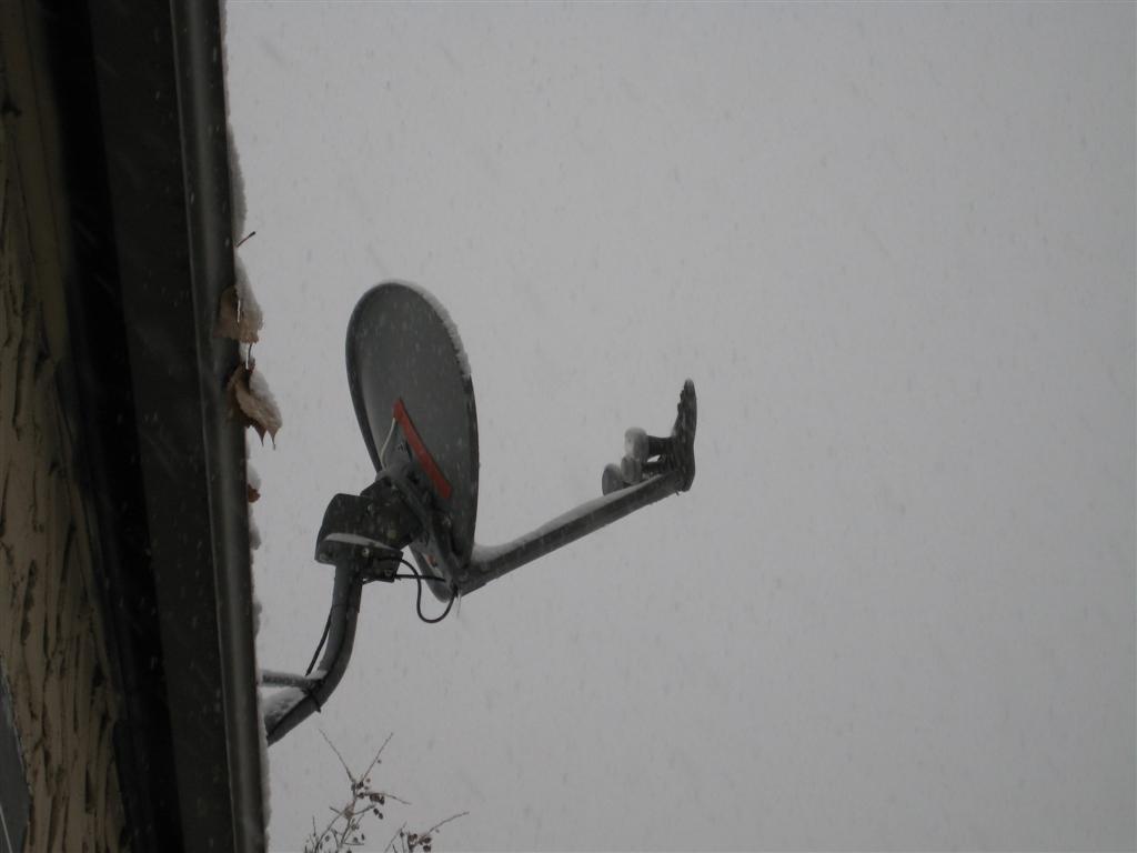

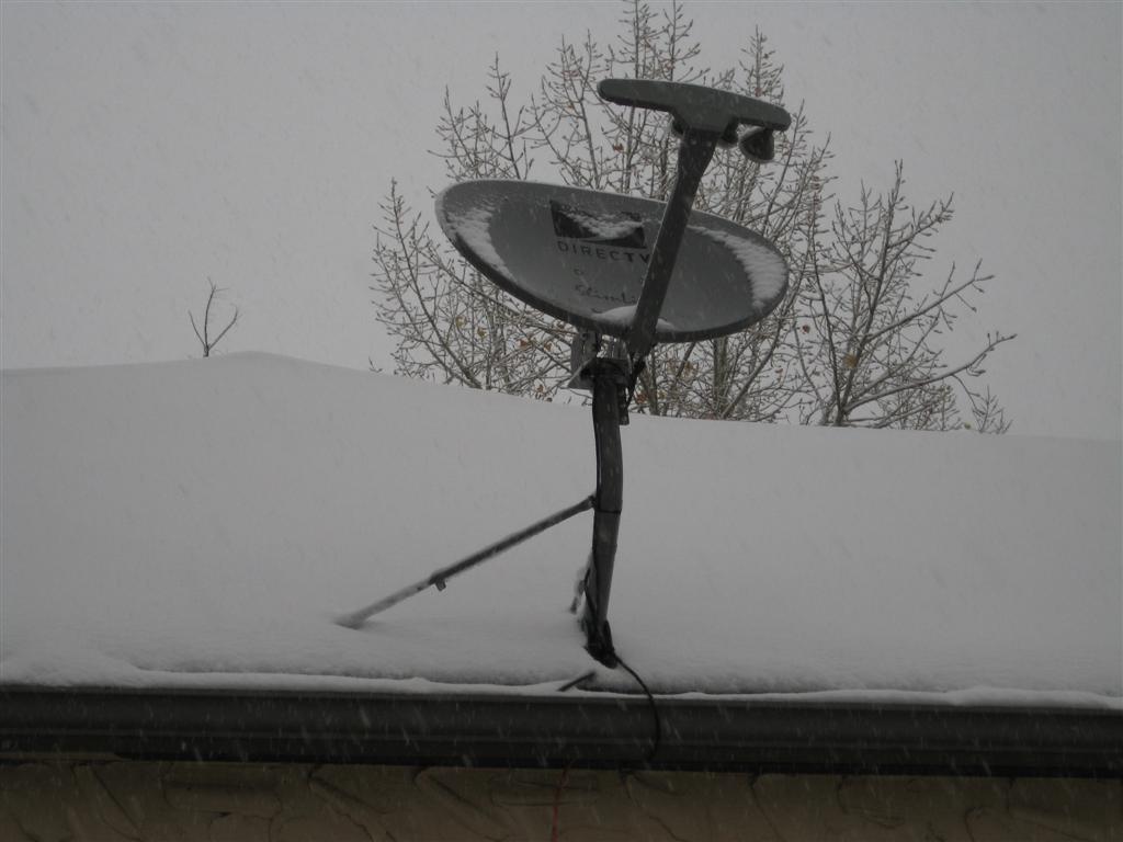

Dish heater experience
I have followed this thread and a couple of others each winter looking for solutions to clear my dish of snow. I live in Colorado and have signal strengths in high 70's and 80's, but if I get about a quarter inch on snow on the dish I loose HD signal. I use to use the hose with a high power nozzle to knock the snow off, but when it's really coming down I have to do that about every 45 minutes – plus there is nothing worst than having to do that first thing in the morning. Didn't want to use any other fluid than water so as not to introduce it into the water table or our dogs which have eaten stranger things. So I finally decided to try a dish heater. I went with the ice zapper 2, because it's cheap ($69) and only use 120 watts (1 amp). It has two rectangular heating elements and attaches to the back of the dish.
Last night out first storm came in and I lost the signal when about a quarter inch of snow had stuck to the dish face. Plugged in the heater and got the signal back in less than 3 minutes. I got the model without the thermostat and just plan on turning it on when I need it. I plan on hooking it up to a plug with a switch inside so turn it on when needed, maybe a timer, but on days like today when it is going to come down all day the timer might be more of a pain that it worth. I have attached a couple of pics from this morning, we got about 3-4 inches of snow overnight and the temperature is right about 30 degrees. I am interested in seeing how it performs once the temperatures really drop, although at temps where I think it might have problems keeping the dish clear would be too cold to snow. Just wanted to relay my experience so far hoping it helps others dealing with this same problem.
Hope this helps.
