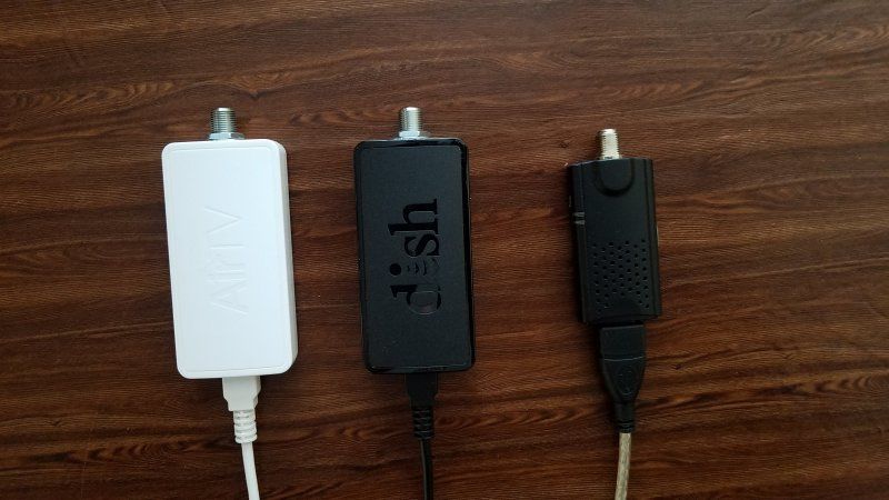

Received my Newest Model Dish Dual OTA Adapter Tuner today, got her installed and tested. Picks up a few more channels than the AirTV adapter and the weaker channels signal is a little stronger.The temp is about the same as the AirTV adapter. See attached.
Thank you for the side-by-side comparison. Very interesting.
Is the new and latest OTA adaptor the one with the cooling holes or the one like the air adaptor?
