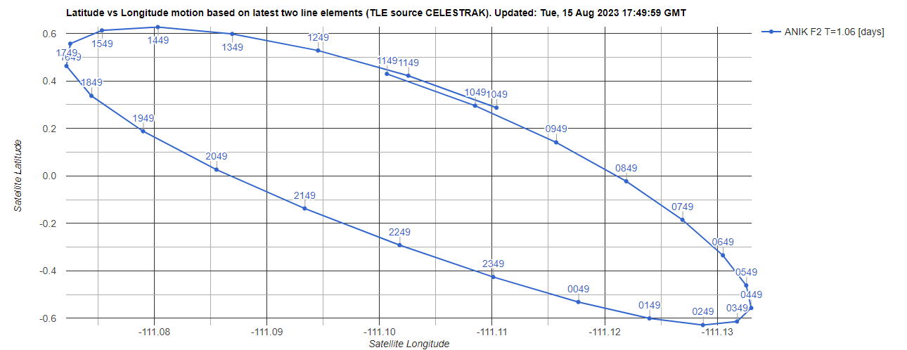

Look at the movement graph above
You will lose reception when the satellite is at the northern end of its elliptical travel .
Those are hour markers on the ellipse. You can see it is at the north "end" for 3-4 hours each day.
The hour markers locations are at Greenwich Mean Time GMT so you can calculate the exact hours you would expect decay in your time zone using the GMT offset for your area.

Are the data points on the graph UTC or Mountain time? The plot ends at 1149 but the chart says it was updated at 1749 UTC Tuesday. I lost reception of CBC Toronto about 10pm Eastern on Tuesday evening, (0200 UTC Wednesday) and it had not yet returned a few hours later. If the datapoints are Mountain time, that would appear to be closer to the middle of the loop, not the end. If they are UTC, that shows me losing signal at the north "end" exactly as you suggest.
My dish is not securely mounted (why bother at this point?) and is probably a bit misaligned, which could cause me to lose signal somewhere else on the loop besides the north "end." Given the small time shift noted on the overlapping segment of the graph, I should be able to extrapolate where the sat is in its loop -- at least for the next few days. If I try to re-aim, should I do so when the sat is the middle of the loop, as opposed to either end?
Woops I was wrong on the time shift. They are local times.
You can get an interactive snapshot of location here:
hover over a time marker on the graph and it will display the time and offset from UTC
Thanks for the direct link to graph, but the times are suspect. On the 170-hour chart, at 1845 UTC (2:45pm Eastern), the most recent data point is listed as 2043 UTC and 4:43pm EDT today. Perhaps the times are CET (Central European Time), not GMT, as listed? Or is the chart making a two-hour forecast? And the 24-hour chart shows positions through tomorrow afternoon, with EDT on the graph's data points, so it must be predictive? It is interesting to see the gradual eastern drift.
He uses the celestrack database which is obtained from the US military (Space Command) they monitor all space objects. It is all predictive but real . The graph will include the TLE which is the last time an actual measurement was recorded which can vary from minutes to days. The TLE includes all data needed to calculate projected orbit
The second graph extends estimates for a week.
You can go to the satellite-calculations main page and set your location .
