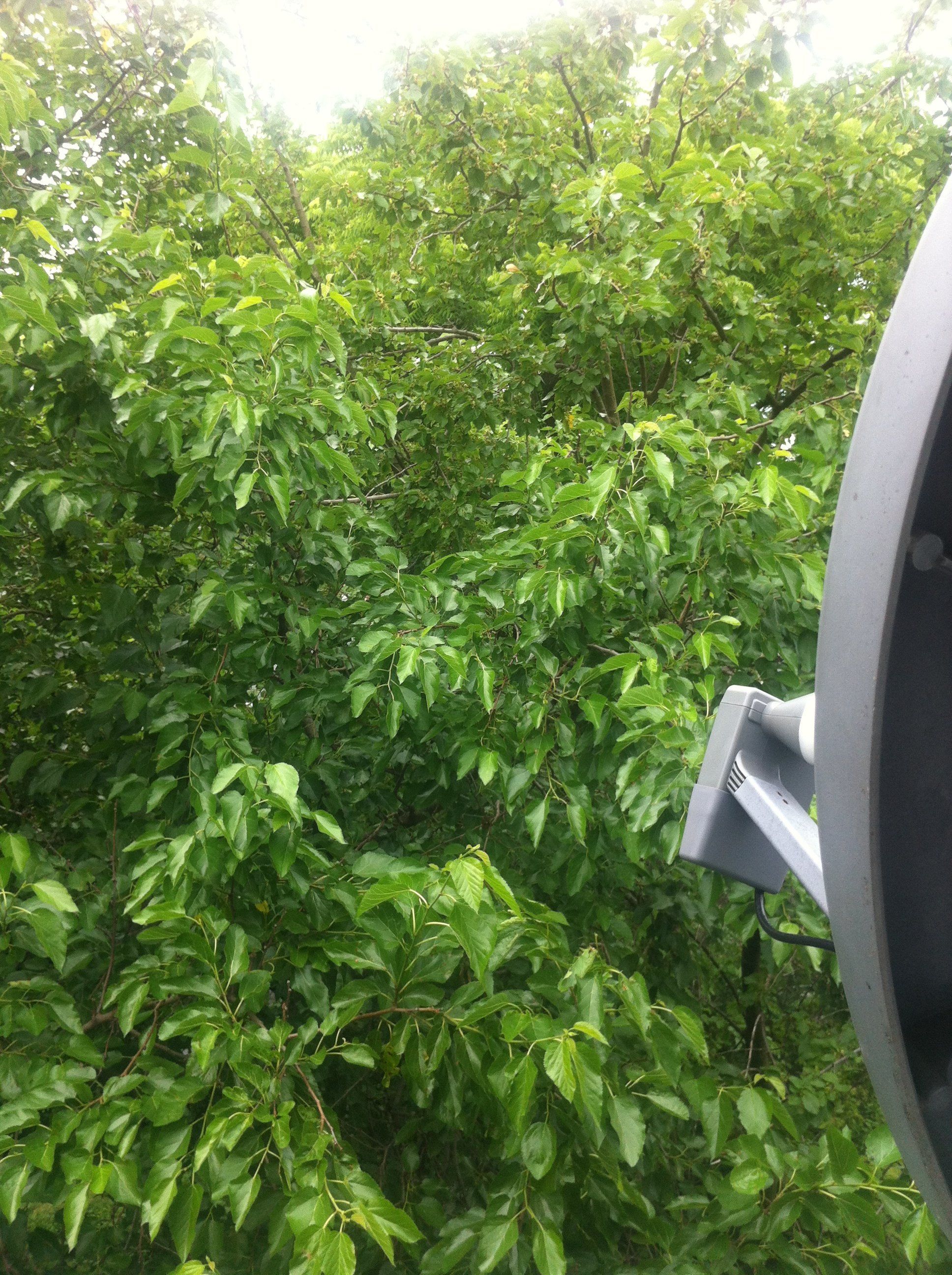

I do get up to 97 on some channels, but since the trees have grown I easily lose signal as soon as there is a little wind. I have attached a picture of my dish for your enjoyment....yes the branches will be cut soon.... photo-4.JPG
I do get up to 97 on some channels, but since the trees have grown I easily lose signal as soon as there is a little wind. I have attached a picture of my dish for your enjoyment....yes the branches will be cut soon....View attachment 88319
