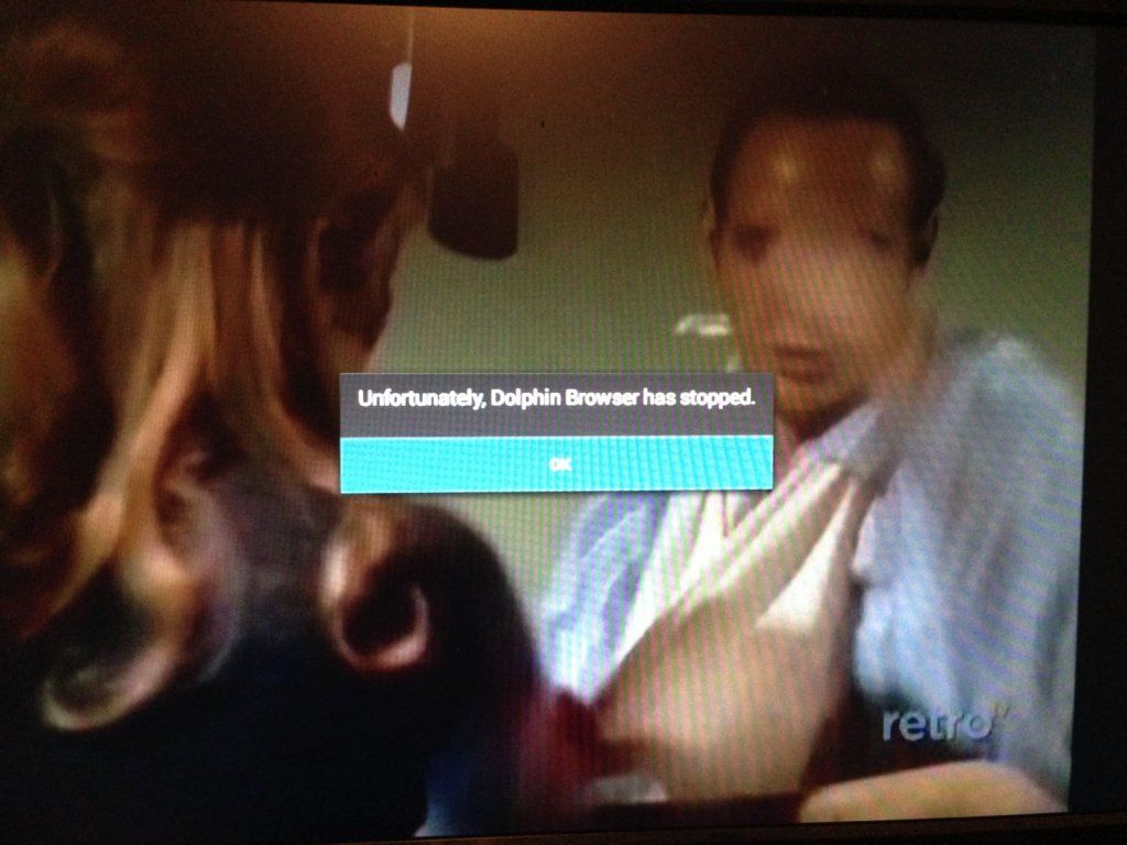

And here we go again. Back to it's old tricks...
:computerwindow
One thing, I held the front button during power up and got into the recovery menu, I wiped the cache and rebooted. When it came back up it had a message on the screen that said "Unfortunately Dolphin Browser has Stopped" and I had to press OK to clear the message.
I am starting to think that there are all sorts of apps running in the background that do not need to be running and that's where the problems are coming from.
There needs to be a way to look deeper into all the running processes (like holding the home button on an iPhone does) so you can kill off unneeded apps from running.
Also there needs to be a way to configure what apps start up on boot or not.

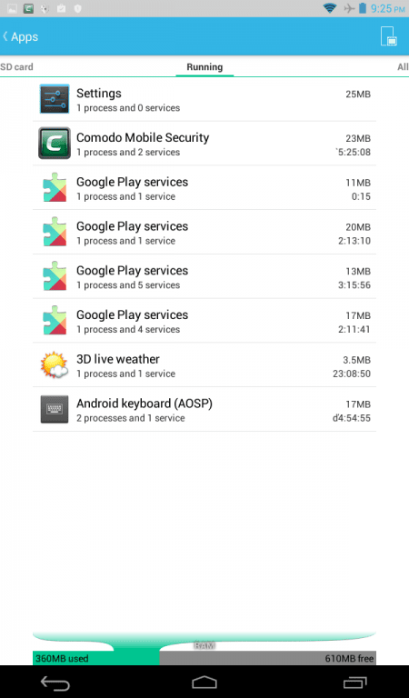

On my my little Chinese tablet you can see all the junk that's running and kill things off.
There was TONS of junk that it booted up and I was able to use an app called Comodo to kill off the junk and prevent a lot of them from starting at all in the first place. But this screenshot that shows running processes and apps is built into Android, it's not from the app store.
I see no such way to do that on the A3.
:computerwindow

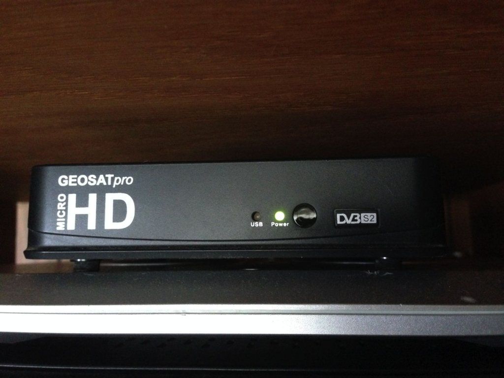

As for a tuner that I can count on, the MicroHD gets 1000% thumbs up from me.
THIS tuner has be absolutely 100% rock solid dependable. Not once has it ever given me the slightest bit of trouble..
I think I probably should just buy another one.
The only thing I dislike about it is that I have to plug in an external disk and that I have to unplug it and move it to my Mac to get files out of it.
That's a bit of a bother but it works. I don't remember but it seems like I've had this thing about 2 years maybe and it's just worked.
No fluff, no nonsense. It's like a butter knife that has only one job, it doesn't cook dinner or start my car or walk the dogs, it spreads butter reliably 100% of the time. And this thing is the same way, it tunes in satellite TV and nothing else, 100% of the time. It's been powered up for months and months on end, I never, ever turn it off for any reason. There's no need to. Every time I change the TV input to this tuner, there it is, playing Retro like a boss..
Apparently simple is better.

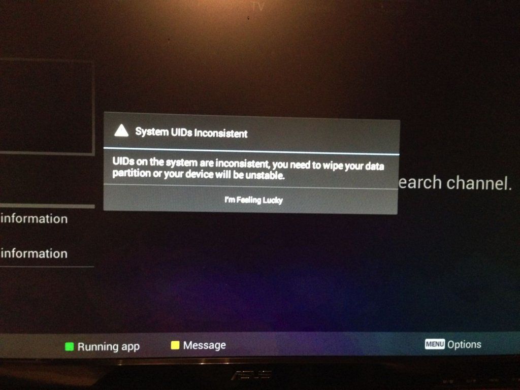

Well through sheer repetition alone I've learned how to go through the recovery process.
Held the front button, cycle power, wipe cache, reboot, wipe user data, reboot, install update.zip, reboot.
Do basic setup just to get through to the system and install 2.0.74. Reboot.
Restore from backup the A3 apps. Run Eurotrash, reboot again.
Restore from backup channel data. Back to watching TV.
For now, it's working again. I didn't install any apps other than what I felt it had to have to run.
Anything outside of the basics I just skipped. I no longer care to try and use it for anything other than a simple satellite tuner.
All those other things, I can do with my Rokus or my Apple TV or my Macs.
All I want the A3 to do it tune and record FTA channels. Nothing else.
I wouldn't even put it online except that it needs to be so it can keep the clock accurate.

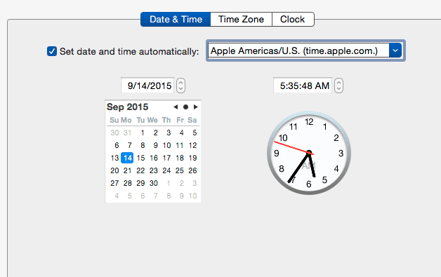

If I can figure out how to have it get the time from one of my Macs rather than the outside world I could completely isolate it from the outside.
I tried shutting of the internet from it but the clock got wackydoodle within a few days and recordings where messed up then.
I found some instructions that I think may let me do this but I don't really understand what is going on with this so I need to do a lot more reading before I try this.
https://theredblacktree.wordpress.com/2015/01/19/make-your-mac-osx-serve-as-a-ntp-time-server/
It seems the guy that wrote that was doing it for a very different reason so I don't know if I could make it work for what I need it to do.
My Macs get the time from time.apple.com and they are very accurate. But this whole android thing, I don't know doodly about it so getting it to sync it's clock from one of my Macs, I don't know..
Surely it can be done but I'm not clever enough to make that happen on my own.
If you plug in the ethernet cable for a few seconds once every day the clock stays fairly accurate on the A3, as long as you don't shut ot off or use the deep sleep option. That's what I do with mine.
I use time.nist.gov for the NTP server.

My turn with the wrong UID and android.com has stopped working. Stuck in boot loop. Worked fine last night,turned it off and today boot loop. A couple of months ago it reverted back to a European model and I blamed it on a power surge, now I am not sure.
Thinking out loud... Love the concept of Android OS on an appliance device, but I wonder if too many cooks really do spoil the soup? Seems like little tweeks in the Android update code have significant impact on hardware and apps. Makes one wonder how hardware and apps are vetted for compliance and remain compatible?
Wiping and restoring brought it back,hopefully it will stay that way. The first 6 months or so were fine, now it is getting a little flakey. But I still love this little box, now if I just had the nerve to load up Kodi and hope it doesn't crash. Even if it does, it's still a great little STB. I am thinking the new A3 will be a lot like the wetek box which is fine by me as long as a ATSC tuner can be added.
