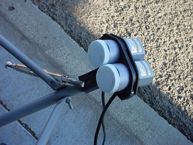

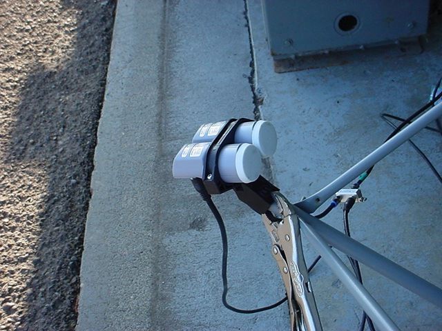

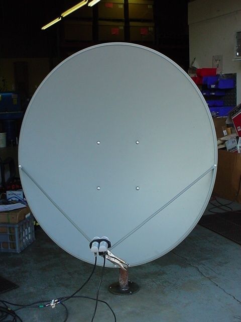

nah. The 36" is the designed idea for the 2 LNB setup. Because the focal point is different on a 1.2m dish that can compensate. If you tried it on a dish with the focal point closer it is still the 4 degrees separation (maybe 3 1/2 max)
I have the Geosat 36" dish and the 2 LNB setup...best I could get was 3 1/2 apart
The GeoSat 90cm and cousins, have an F/D of only .5
I expected more like .6 or .7
They are a particularly unfortunate choice for narrow satellite spacing.
Specs on the Fortec say it has and F/D of .6
Not saying it'd work, but at least we're moving in the right direction.
Not that I mean to imply that the F/D is the main concern.
The focal length is!
But the above two dishes are both 90cm and the larger F/D has the longer focal length.
Naturally, the 1.2m with its longer focal length, has the advantage, regardless of its F/D.
