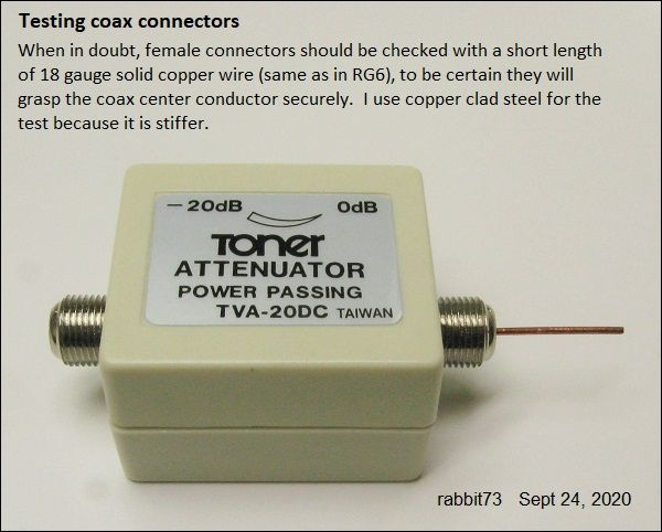

If you have any doubts, female coax connectors should be checked to be sure they are reliable.
